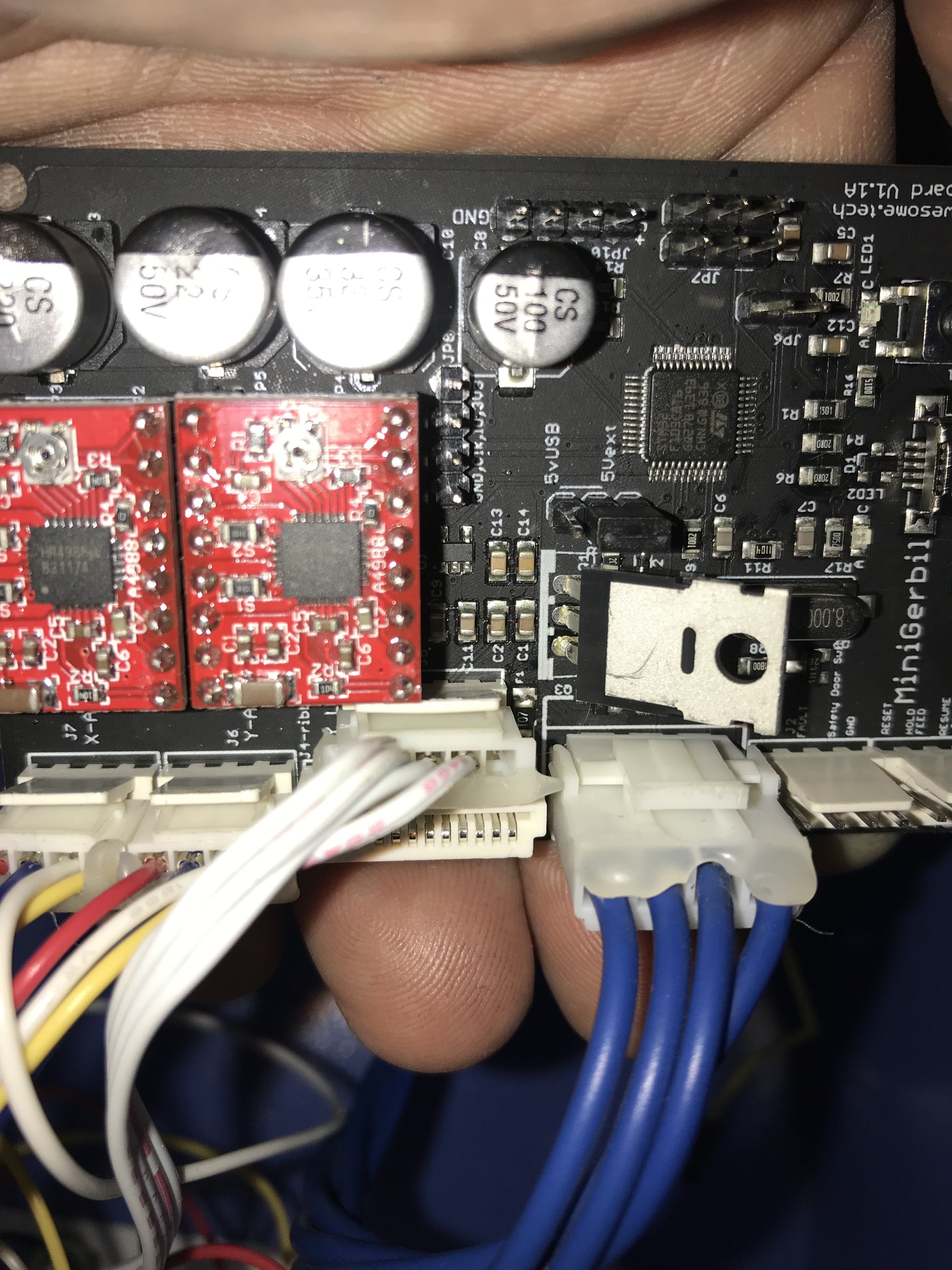

Been reading thru the forums didnt see what i was looking for. Everything works just cant get the laser to fire i crated macro in light burn but no luck. So for the mini G what is the 1.1f Configuration. should $30=1000 or 255 i know its supposed to match in light burn i will post my config and anyone if they could look it over maybe i need to change some of them.
$0 = 10
$1 = 255
$2 = 0
$3 = 1
$4 = 0
$5 = 1
$6 = 0
$10 = 31
$11 = 0.010
$12 = 0.002
$13 = 0
$20 = 0
$21 = 0
$22 = 1
$23 = 3
$24 = 2000.000
$25 = 2000.000
$26 = 250
$27 = 2.500
$28 = 5
$30 = 1000
$31 = 1
$32 = 1
$100 = 157.000
$101 = 157.000
$102 = 160.000
$103 = 160.000
$104 = 160.000
$110 = 12000.000
$111 = 5000.000
$112 = 5000.000
$113 = 5000.000
$114 = 5000.000
$120 = 8000.000
$121 = 3000.000
$122 = 3000.000
$123 = 3000.000
$124 = 3000.000
$130 = 230.000
$131 = 320.000
$132 = 200.000
$133 = 200.000
$134 = 200.000
baud rate 230,400
