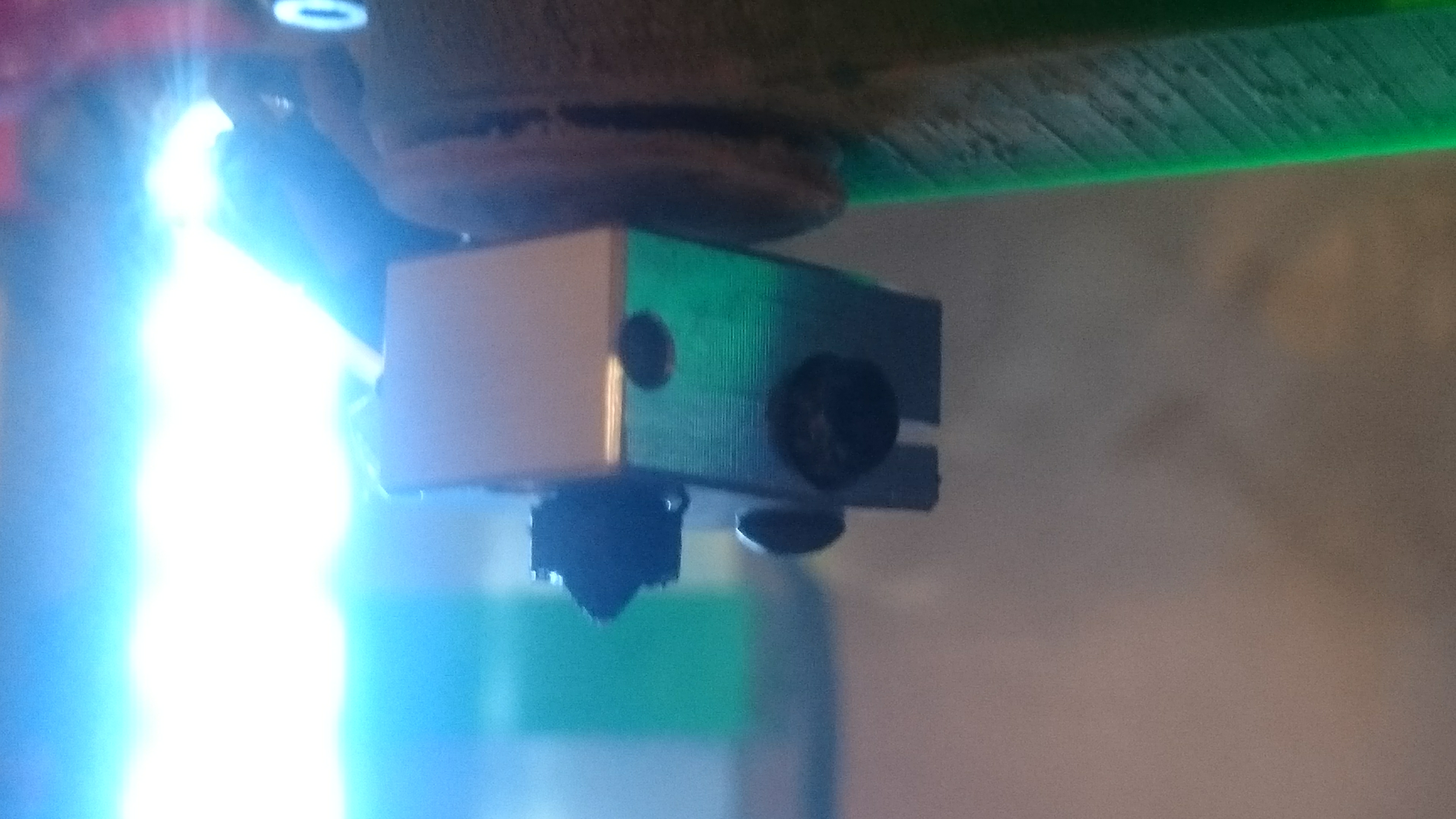

Just installed the new e3d v6 heaterblock+thermistorcartridge.
Just installed the new e3d v6 heaterblock+thermistorcartridge. This is awesome! Love it!
What is all over the heat sync? Looks like it would suppress the heat dissipation of the heat sync.
@PrintinAddiction
Thats ABS vapor gunk ;D No problem at the fan-shroud theres not gunk ^^
Ah, I haven’t tried ABS, does that happens just from printing it or are you vapor smoothing it also?
@PrintinAddiction
No thats only from printing. Its not only ABS but some others too. But not on PLA or PETG. I brush it off from time to time.
Get the same from Printing PETG, tbh.
Taking it was a nice easy install @VolksTrieb ?
Well had to solder the new connector (for the thermistor) to my cables but beside that its a dream. Reads the temp much nicer now. Can turn my Fan on full power and it holds the temp up to 260°C. Before it somehow blew the thermistor cold (which would result in too high temperature at the nozzle).
Back to the installation: Yes stick the cartrige in and tighten the grubscrew (but carefully) and your done :wink:
