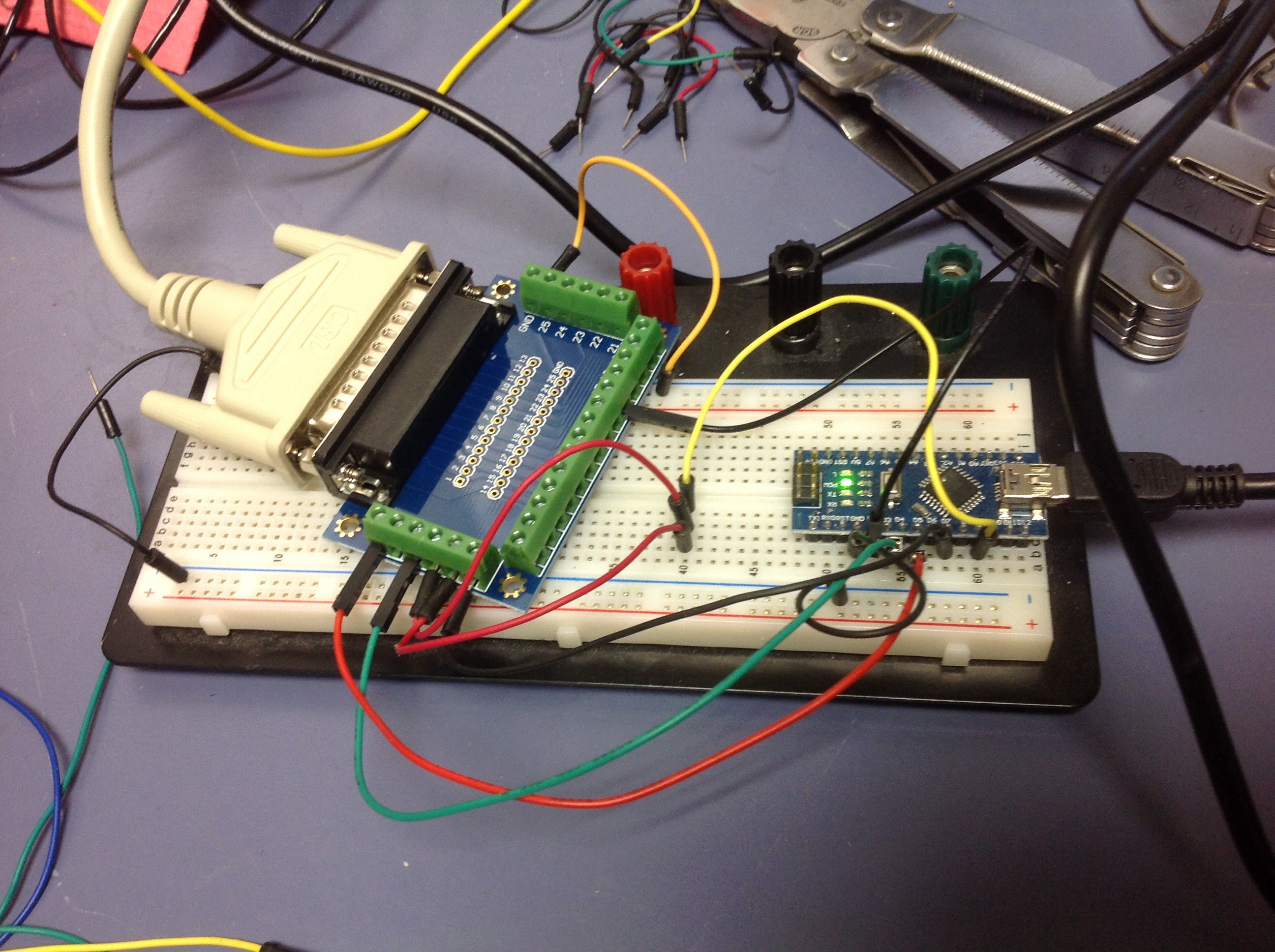

Just introducing myself. Current project is controlling a parallel port cnc controller with an Arduino and GRBL.
Originally shared by David Kirtley
Interesting. Looking forward to see where you’re going with this
Eventually to a more interesting sender program that can do more complicated things more like canned procedures and better interactive use (conversational mode). Also staying away from a dedicated shop computer and just bring out a laptop and connect to USB when using. I did this post as a response to someone else in a different place but decided to go ahead and start meeting people in DIY CNC.
