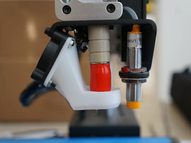

I find this fan shroud provides the best surface quality so I’ll be making a revision of it:
Awesome! The model description on that page does say it works with the latest hot end
It doesn’t. If you print in ABS you can force it but it I wouldn’t really call that fitting.
True.
