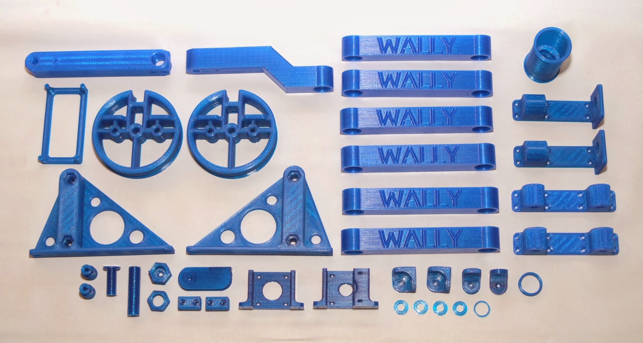

Just printed a complete set of Reprap Wally parts for “Smooshed” on the reprap forums. @Nicholas_Seward should enjoy seeing these!
I am few parts into it too
good luck in assembling it.
I hope you will be sharing the building process - it’s extremely interesting!
These actually are for someone else. However, I do know he will be documenting his build process over on the reprap forums.
Awesome! Those look beautiful.
I was really impressed how well they printed! I had no problems with bed adhesion either using hairspray + 65C.
What 3D printer did you use to print these? The quality of the print looks really good!
I printed them on my Graber i3 (GitHub - sgraber/Graber: Graber 3D Printer). @enhydra should be happy to see the quality coming off of this printer. ![]()
Nice print
FYI even more photos on my Flickr photostream: http://www.flickr.com/photos/sbgraber/sets/72157637939518655/
Nice, I may take a crack at this guy…
@Shane_Graber These parts look definitely good.
