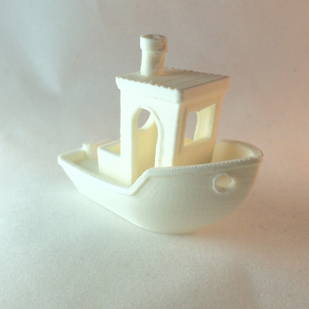

Just printed the first time with #verbatim #abs Filament. I am blown away! Printed the #Benchy at 80mm/s (120mm/s infill) with no warping at all, even the bow did not bend up . I had no cooling, 0.2mm layer, 240°C Hotend, 110°C/90°C Heated bed.
Man, i printed several Benchies in ABS, but this is my all time best!

That’s a good result particularly at that speed! What printer?
@Jos_van_der_Plas its a custom CoreXY like a sparkcube

What’s up with the odd bulge at the top? Also your last perimeter layer on the box seems to not be connected.
@Adam_Steinmark The bulge at the top comes from the hotend staying all the time above the same spot and the filament cant cool down. You can’t compare PLA prints with ABS ones. There is clearly room to become better, but at the speed and no cooling, I am satisfied with the result.
