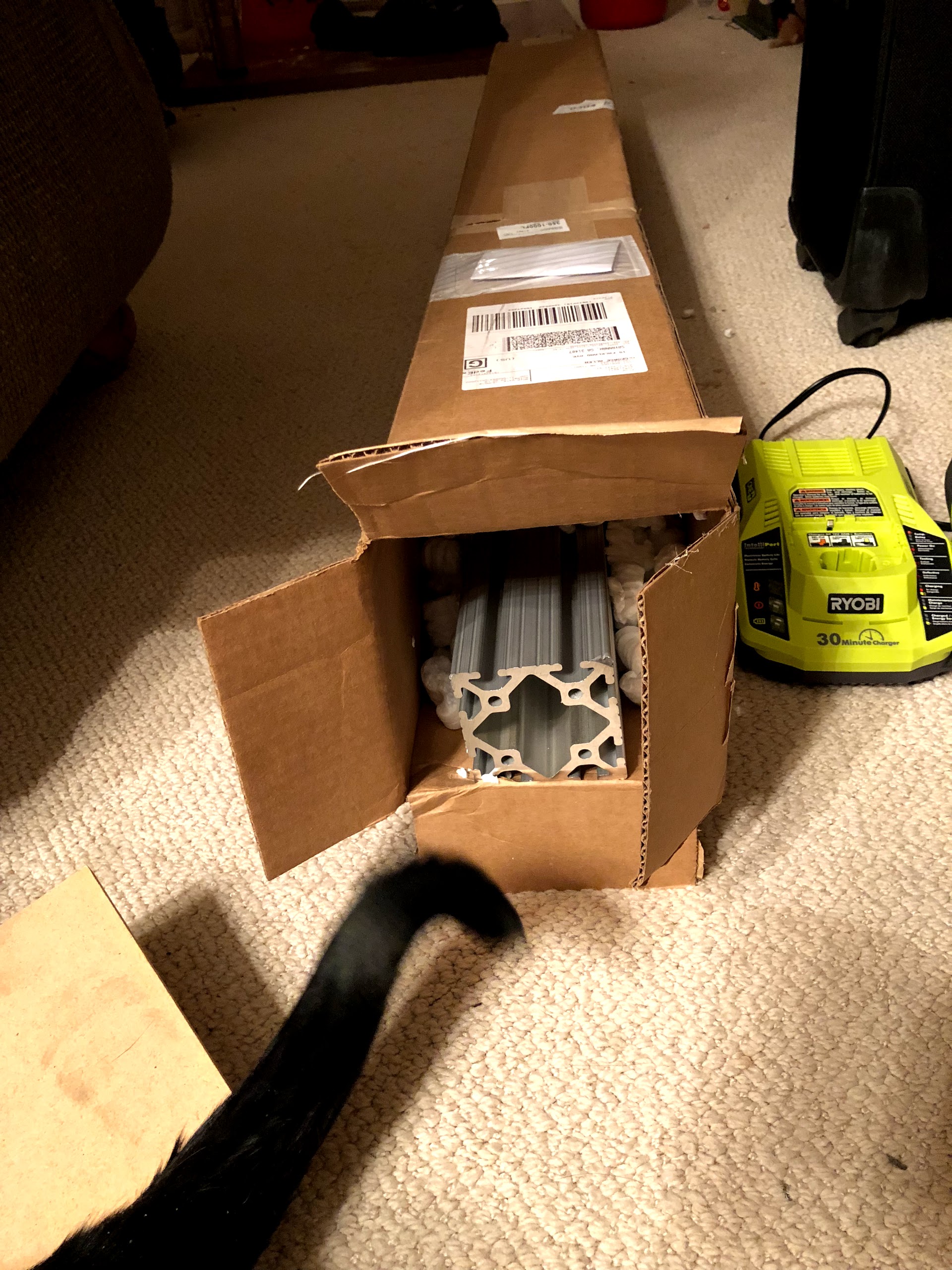

Just received my 3030 (80/20)rail that I intend to use as the gantry. I received my 2 1030 (80/20) rails earlier last week. I feel kinda “out over my skis” on this one.” However, I felt pretty much the same on the last one. Also got my NEMA 34 last week (standing next to NEMA 17), as well as a NEMA 23 with gearbox. Some pillow block linear rails are on order with lead screw/ballscrew and bearing mounts. I’m wondering if I should make some mock up designs of the plates that I will later either cut or have cut before making a quick decision. It’s obvious the gantry will be pretty heavy. The question will be how heavy is too heavy.
I like that rail. It should have good torsional rigidity.
Yes, I think so. I’ve seen a lot of designs using it on their machine. I actually just ordered another one (45”, I think) for the build. I may reduce my x-axis length to 750 mm, whereas initially I was thinking 1000. I could use 2 beams instead of 1, but my concern was the weight.
