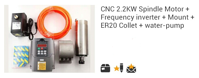

Just received my spindle for my soon to be home built CNC, which is not yet finished. it looks good and all parts seems good quality.
How much was that little lot I’m after a new spindle
Let’s just hope all of that stuff lasts longer than a lot of other imported merchandise seems to these days.
That is the setup I have on my machine. It’s worked awesomely for me! I don’t use it 8hr a day 7 days a week but when I turn it on it works great!
where you bought this kit? and how much it cost?

@Henrik_Larsen1 I am envious. That’s what I plan to use - not sure about the pump yet. Will you use a radiator or just a big bucket? Did it all come from one seller or individually? Does the spindle have good bearings?

This lot was about 400USD, give or take some, depending on freight. My friend was able to get some discount, because he bought it with other hardware as well.
The pump is just going into a bucket with 20-30 liter of Water. A transparant storebox with a snug lid, placed under the milling table is perfect. I’ll probably use demineralized water to prevent bacterial growth.
This was a kit, i.e. one parcel with all the stuff. The spindle is pretty quiet, with is a good sign of long lasting bearings. Other than that I don’t know.
Thanks @Henrik_Larsen I see you even got collets with it. Excellent. I hadn’t seen that package before. What does the quality of the spindle mount look like?
The mount @Peter_Fouche is extremely sturdy. No problems there. It may even be well over requirements. You have to drill holes for mounting the mount yourself, that would be an advantage for most.
