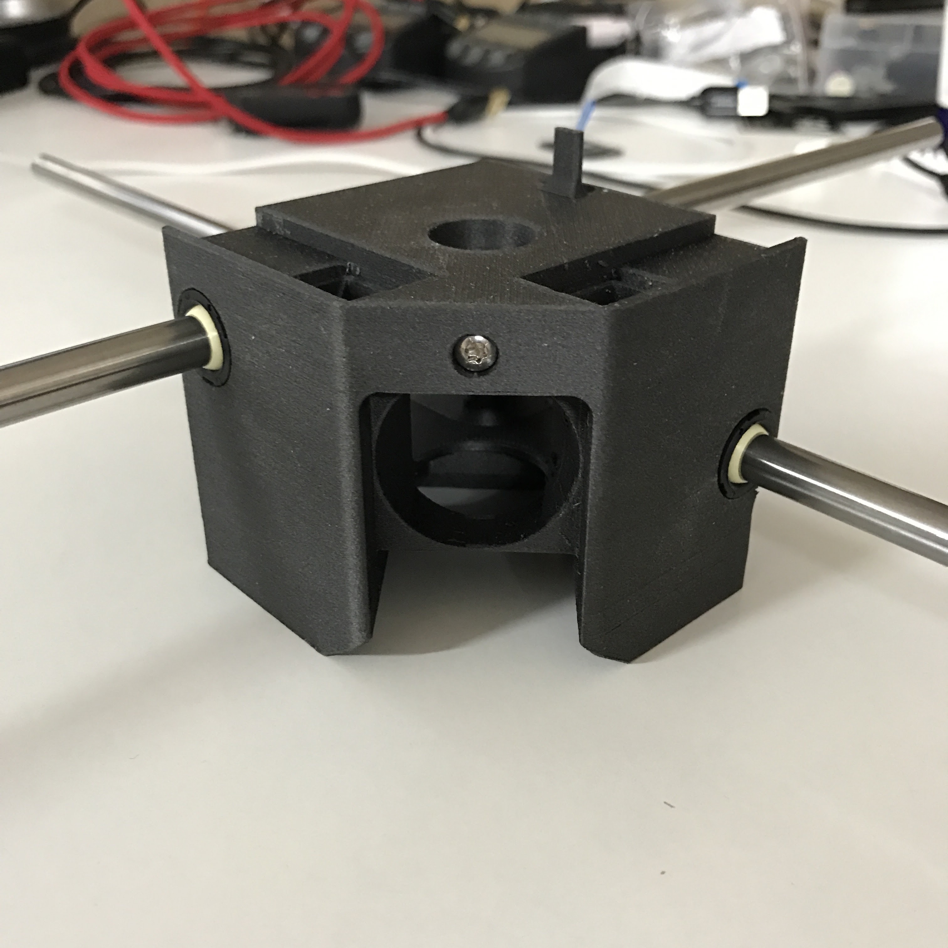

Just received the samples from @igus_Inc today and put them straight into my first print. Fits quite nice and feels great though they have a little bit of play. At the end its still less than I had with the LM8LUU before. It’s really hard to get some good ones of these linear ball bearings.
How’s the play with the bronze bushings you guys are using?
For reference: These Igus ones are Igubal ECLM-08-02. If they work well here I will probably also give them a try on the 10mm rods on the outsides.
