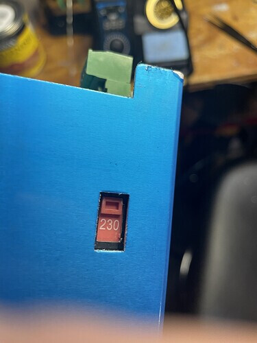

Gotcha, most of times there will be a switch on the side of the laser power supply for using either 115 or 230.

had a look on the photos but can’t see the switch, have messaged the seller to see they say, if you are looking at the machine front on where was that on your machine, thank you
The switch is on the side of the laser power supply which is inside of the machine. So it’s not something easily visible.

Can’t remember if mine has a switch but it’s definitely happy on UK mains
