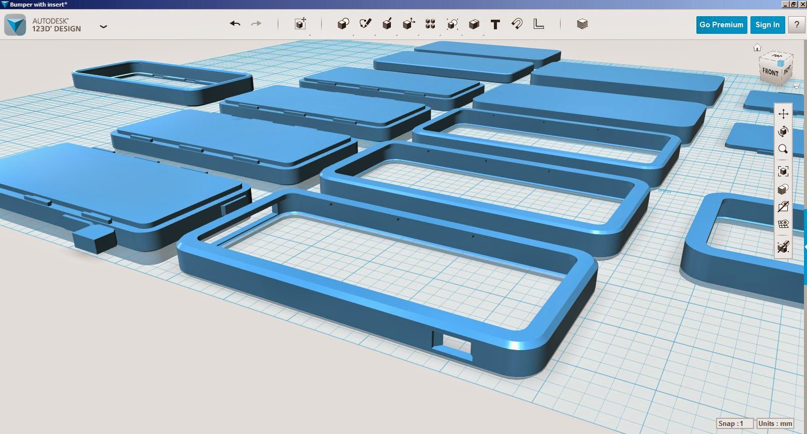

Just sharing some drawing experience… Autodesk 123D Design is excellent in some regards when designing for 3d printing, but I’ve found it quite frustrating to figure out how to modify finer detail later on a given object. I’ve taken to retaining design progressions within the one drawing, so I can quickly step back and re-design if required, once I’ve test printed. (when you save you loose “undo”)
Also, I’m finding it’s ability to cleanly subtract one solid from another very useful, as in my approach to drawing up a phone bumper in which I drew the phone and it’s buttons, extending buttons where I wanted them pushing through the bumper, then subtracting the modified phone object from a solid block to reveal a snugly fitting bumper. Adding bevels or rounded edges is a breeze.
I can recommend 123D Design as a tool to quickly draw even a moderately complex object for 3d printing.
