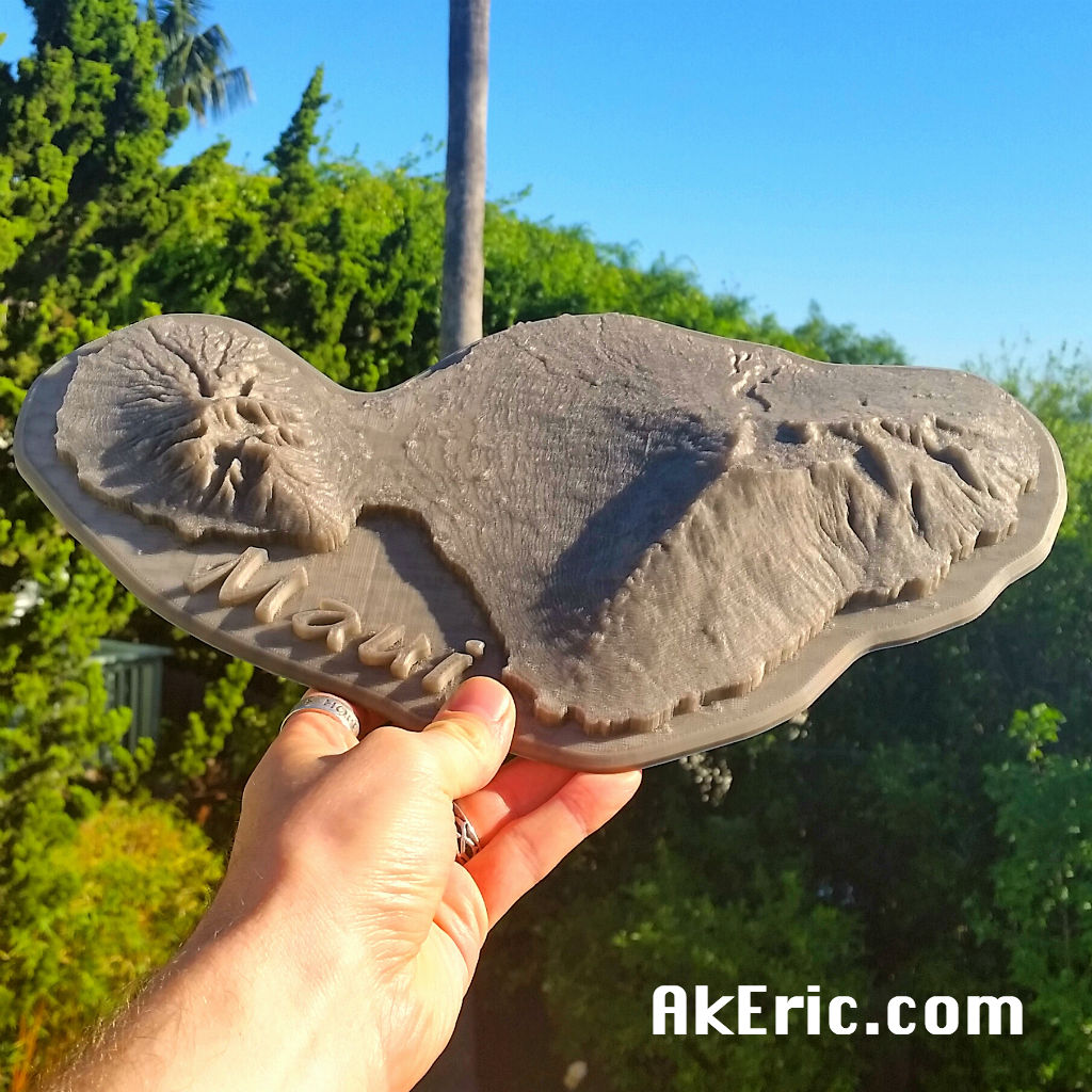

Just spent a week on Maui: When I came back I felt inspired to make a 3dprint of the island. Printed diagonal on my C-Bot’s 12x12" platform, it’s 14" across.
I had to download a bunch on individual chunks of the island mesh from the terrain2stl web app, then seam them together in Maya(quite a few hours of work…), + add the base and text . Sliced in Simplify3d, 200 micron, .4mm Volcano nozzle at 90mm\sec, 20% infill (probably should have done 10% to help with some of the roof issues), 2 shells, took about 13 hours in Makergeeks Gray’matter Gray PLA.
I’m pretty happy with it! Next up will be paint.
