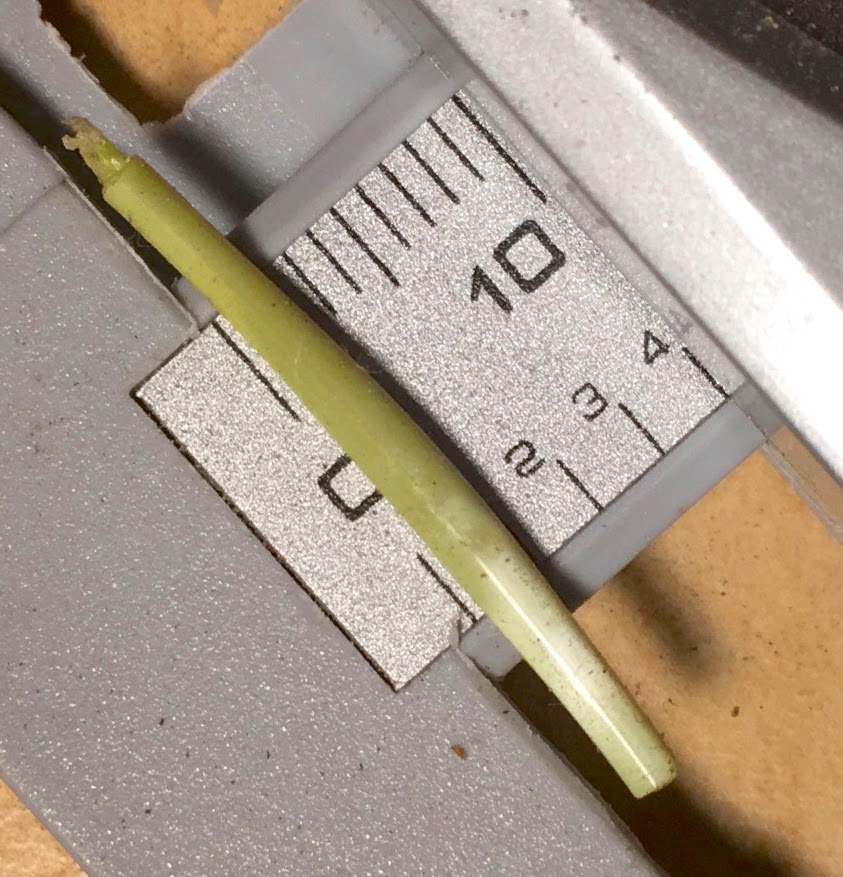

Just to summarise what happened when I thought I had a clog ( https://plus.google.com/+YuanLiuTheDoc/posts/gnPXLAAkxa6
Just to summarise what happened when I thought I had a clog (Sign in - Google Accounts). It was some 15mm of really bad bulge in the multicolour filament shipped with Ares. This segment could not pass through the short tube, so it shows the symptom of a clog in extruder. One more spot to check when extruder stops working.
