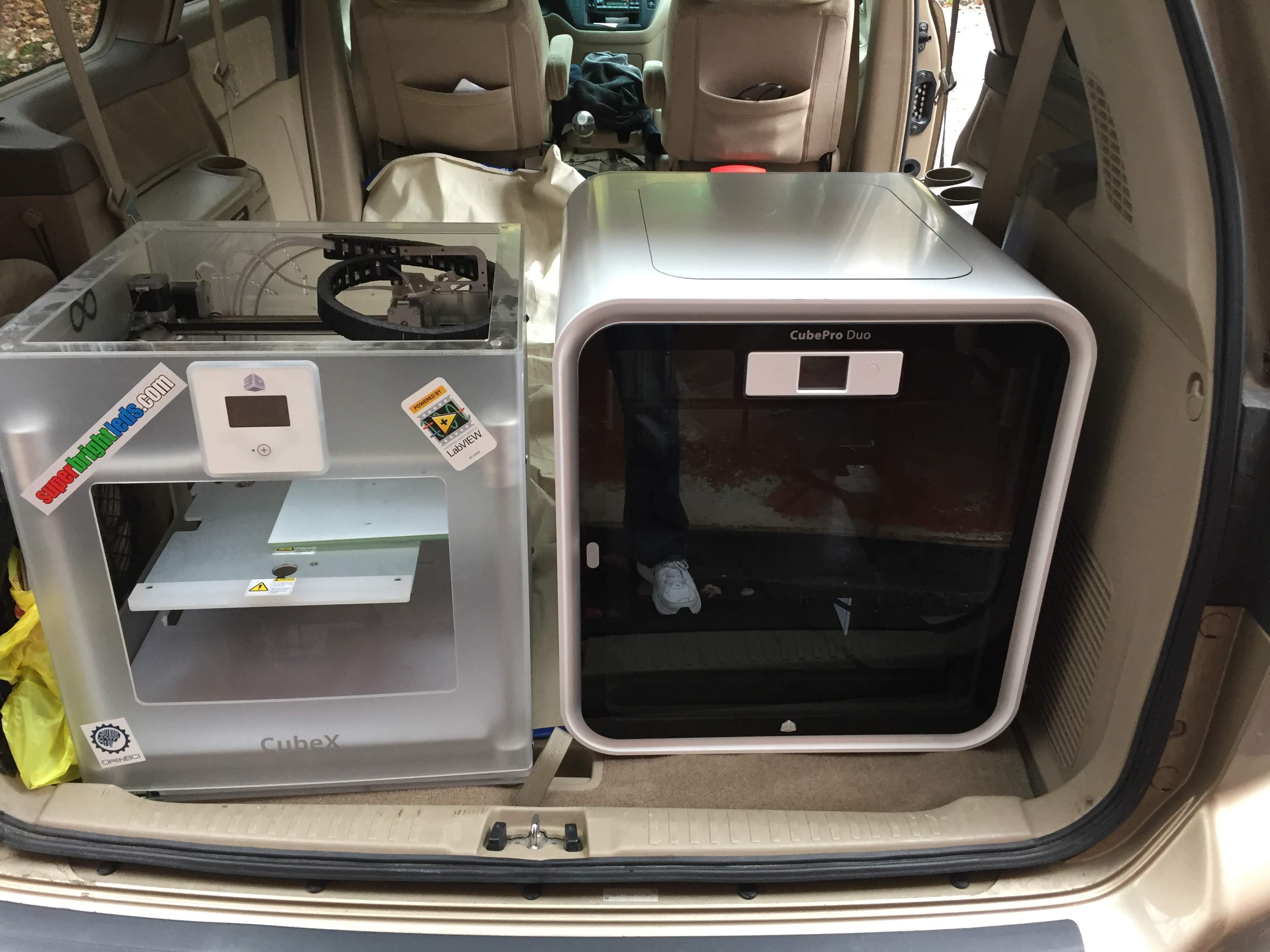

Just took a nice scenic 3.5 hour round trip to Manhattan and back, got some stuff.
Oh, CubePro isn’t the most movable benchtop 3D printer as I remember. :wink: (I have tested CubePro Duo 1,5 years back and it was quite a nightmare. Any plan of conversion/total upgrade?)
That’s the only plan. Heated bed, new controllers, and hotends. The Pro should become my new ABS printer. The regular, I am not sure yet. Maybe I will do some multiple head tool changer stuff on it.
man those printers are piles of crap. But id love one to re-control like this.
The rigid structure of CubePro is potential platform for CNC. :wink:
I wouldn’t say so. I have real CNC’s with ballscrews and Nema 23’s on all axes. I still have to be careful cutting aluminum there. I do need an enclosed printer for ABS. So this will be for that.
man, where do you manage to find things like this? It would be so cool to work on a random printer and bring it to life, but I’m way to busy upgrading my simple metal :stuck_out_tongue:
I honestly have no idea. I’ve gotten some stuff from the awesome community members. The guy I got these from was my neighbor at Maker Faire.
@raykholo nice! Well gl on the upgrade👌
Those one are beasts to move, but they are pretty rigid and make a great retrofit base :slight_smile:
