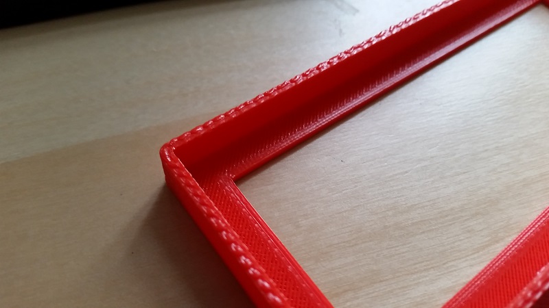

Just tried out Slic3r 1.2.9 stable over 1.1.7 stable and for some reason I'm
Just tried out Slic3r 1.2.9 stable over 1.1.7 stable and for some reason I’m getting over extrusion on the perimeter , so as I went back to 1.1.7 issue cured.
Any idea’s what I may be missing?

I too have started using 1.29 as I was unable to get versions past 1.17 to work on ubuntu. In the release notes, he refers to a new feature to keep the volumetric speed constant. I think variations in filament diameter with this will show more readily. Upon seeing this problem I rechecked my filament and settings to correct.
On the update, it seems like the over-extrusion modifier automatically sets it’s value at 15-20% so check in the advanced options to see where it’s at before you start your print.

As far as I can tell nothing is different in my settings, but I’ve just found out it’s printing with 100% no matter what I have it set at…

Bit of an update, I’ve just upgraded Repetier-Host from 1.0.6 to the new 1.5.2 and tried printing the pictured g-code again with Slic3r 1.2.9 and all seems to be fine now.
I’m guessing Repetier-Host 1.0.6 and Slic3r 1.2.9 didn’t like playing together…
