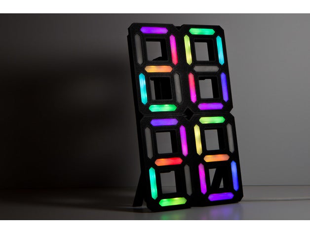

Just uploaded a smaller version of the clock I made recently. This version only has 2 leds per segment and can be built with way more printers now as the biggest part has been reduced to 118mm x 141mm (max. Z height required is only 15mm). Also it’s only using two led strips and is very easy to build
