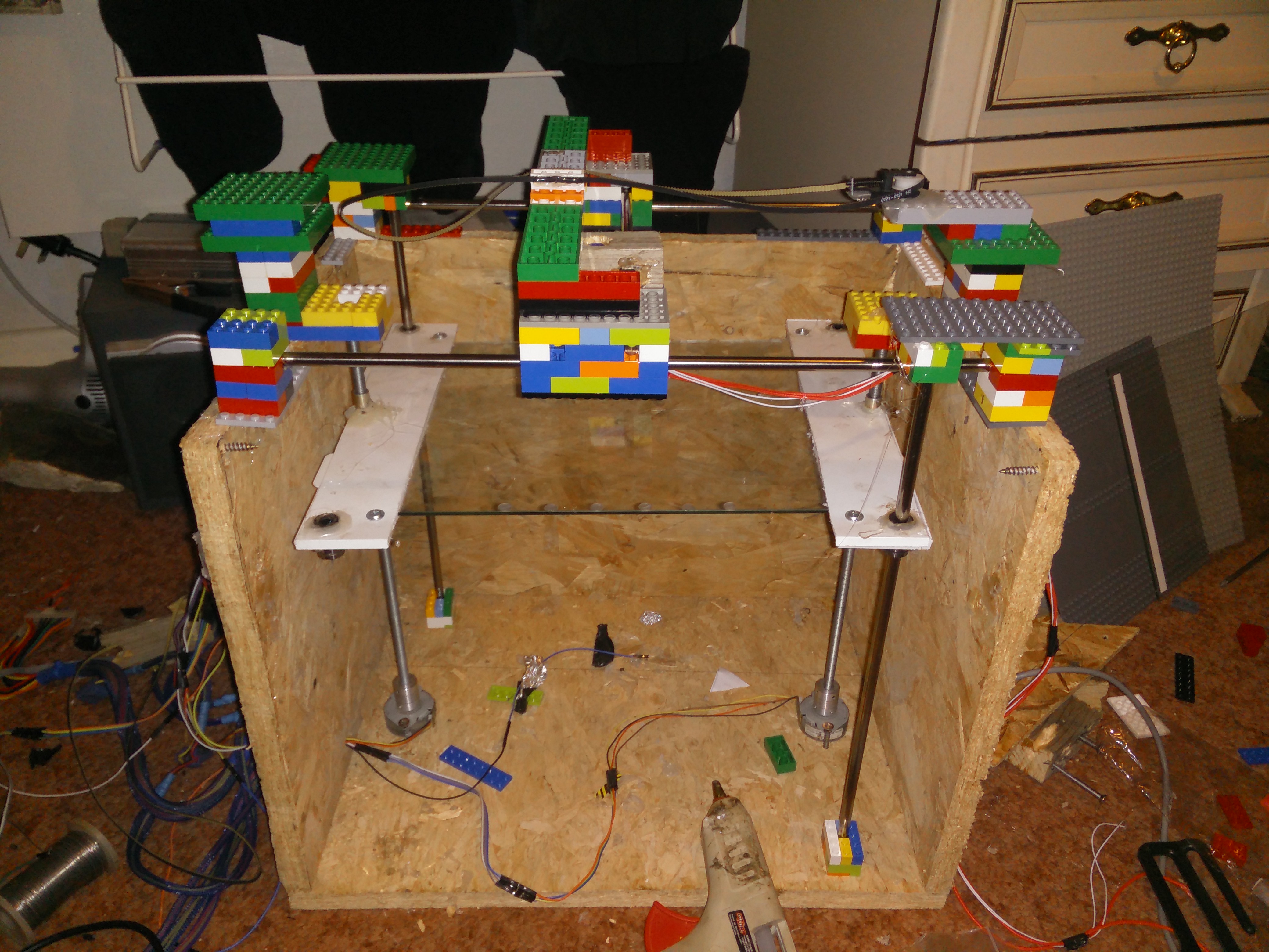

Just waiting for a few more parts to arrive, the extruder is working great! (It is my first 3d printer)

@Nathan_Walkner The z motors are mitsumi M42SP-6t I salvaged from some old printers. They are 4wire bipolar motors. I am using ramps 1.4 with repetier host firmware and they run fine!
Impressive if you can get it to work. Are the LEGO bricks glued together?
@Adam_Steinmark The linear rods and bearings are glued to the lego bricks but the lego bricks aren’t glued to each other.

Looks like a good candidate to convert to a smartrap! Are you using 6mm rod on your x and y axis’?
@Griffin_Paquette No it’s 8mm rod.
