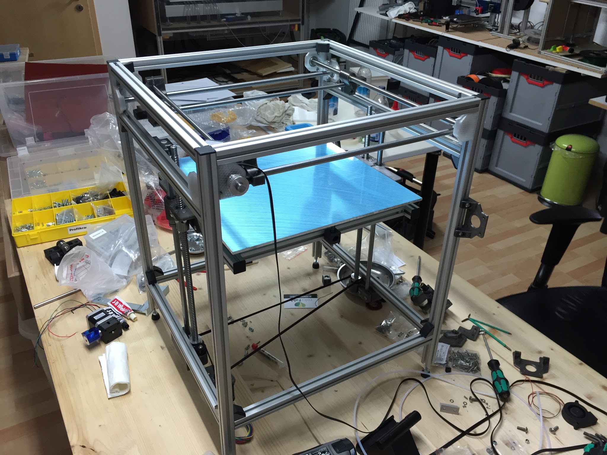

Just wanted to leave a short update on our build. Finally got something done yesterday. The x/y carriage still needs some work as the bushings (Robotdigg graphite bushings) don’t align well yet. Need to reprint the carriage with higher quality and be a bit creative with the accessories (sleeves and stuff).
Are those the ‘Selfgraphite’ bushings? I’d be very interested to know how they work out.
yes they’re the ones with the graphite depots. The first impression is quite nice though aligning them is a bit of a challenge due to their length. Of course also the self aligning feature is missing.
