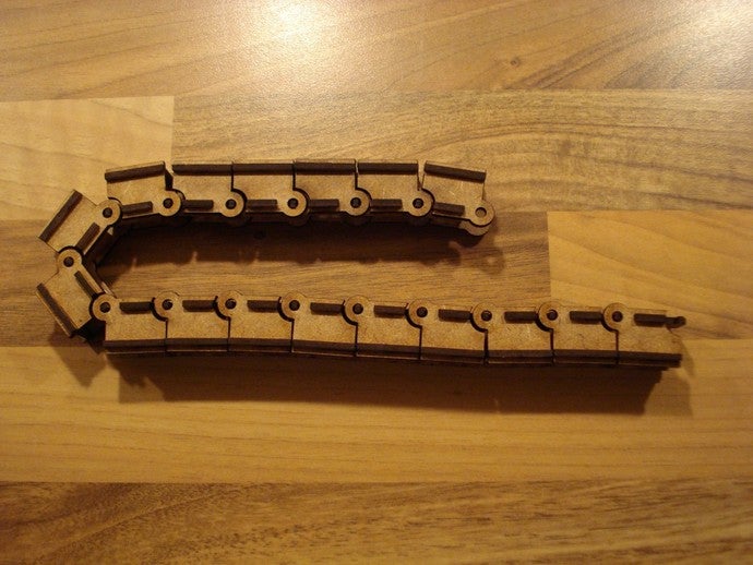

Just wanted to share. Drag chain that can be cut by your laser. Not my original design, so im not taking credit for it. But modified it so that you dont need to glue them.
order of assembly is to attach the two sides and bottom first (like show on the pic below)
then put the top part where it meets the hinge.
then slide the top part to complete the one module. ( see pic below)
the svg file i created has a inside dimensions of 35mm width x 25mm height. I want for my extension cord to go inside wihtout a problem. You can alter the dimension to whatever you want.
Also, I am using a 2.8mm thick mdf board, so your thickness may vary.

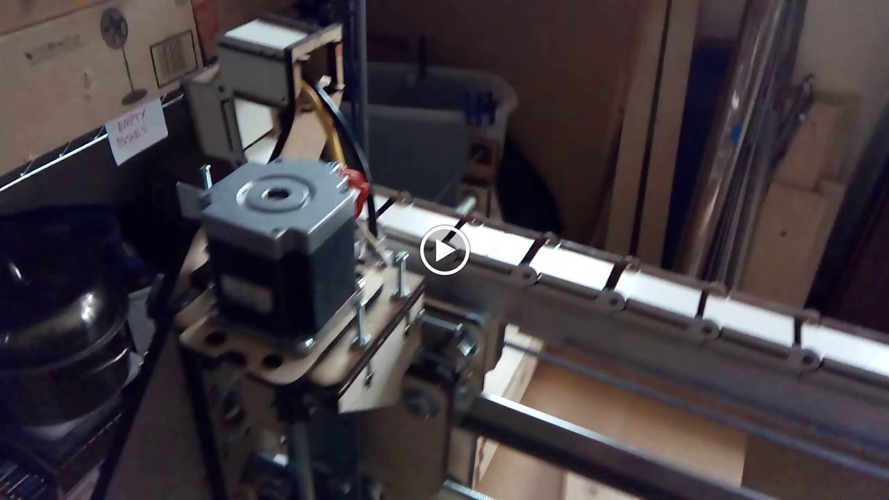

Although i am using this for my cnc project. You might be able to use it for your K40 also.
