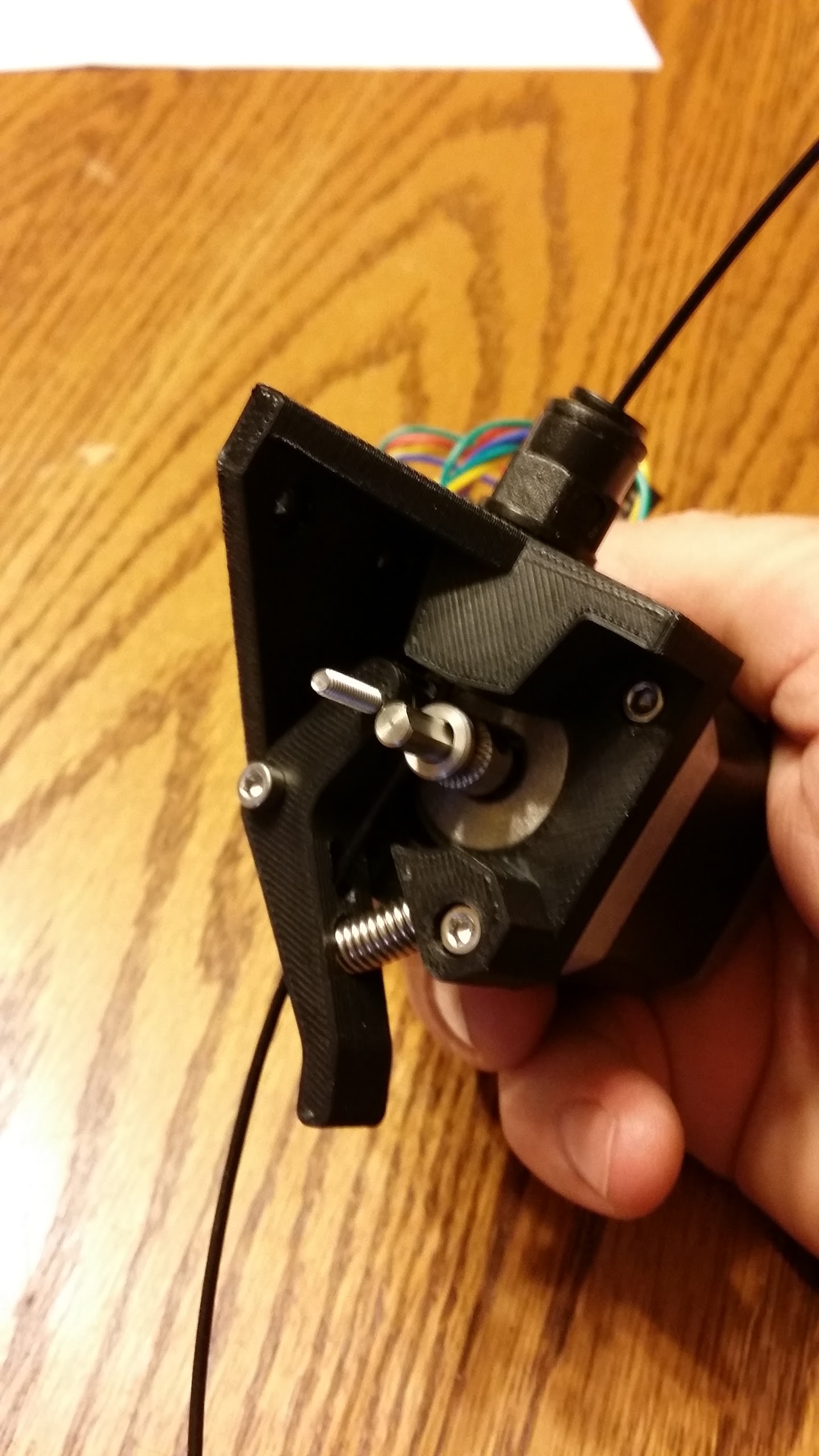

Just wanted to share my new direct drive extruder.
Just wanted to share my new direct drive extruder. It has the mount built in to fit in the upper left corner of the Prusa I3 frame on the back side and uses the bolts from the upper left Z rod holder.

That is really nice! And great print!!! Where you direct before as the i3 is built?

@Brandon_Satterfield Thanks… I’m really happy with the way my printer is printing but you know how it goes… Always got to try and make it better. Currently I have a geared extruder set up Bowden style but I wanted to try direct to see if I could get even better prints than I’m getting now.
That’s great @Mike_Smith I have always ran i3s either geared or direct, single and dual extruder, on the x axis. After everything my absolute best performance came from a Budda on a Wade’s, currently on an e3d on a Wade’s. Love to know how the direct Bowden works out for you.
@Brandon_Satterfield what direct extruder did you use? I’m setting up my i3 now and was going to use a wades but I’d really like to slim down to a simple direct that’s proven.
@Joe_Spanier I found a whosit based direct drive set-up on thingiverse that mounted to a x-carriage that I had printed for the Einstein invariant. I also ran the dual extrusion this same way. There are photos on here somewhere, I think.
What I found after all was said and done is the control of filament, for me, was superior in the geared set-up.
