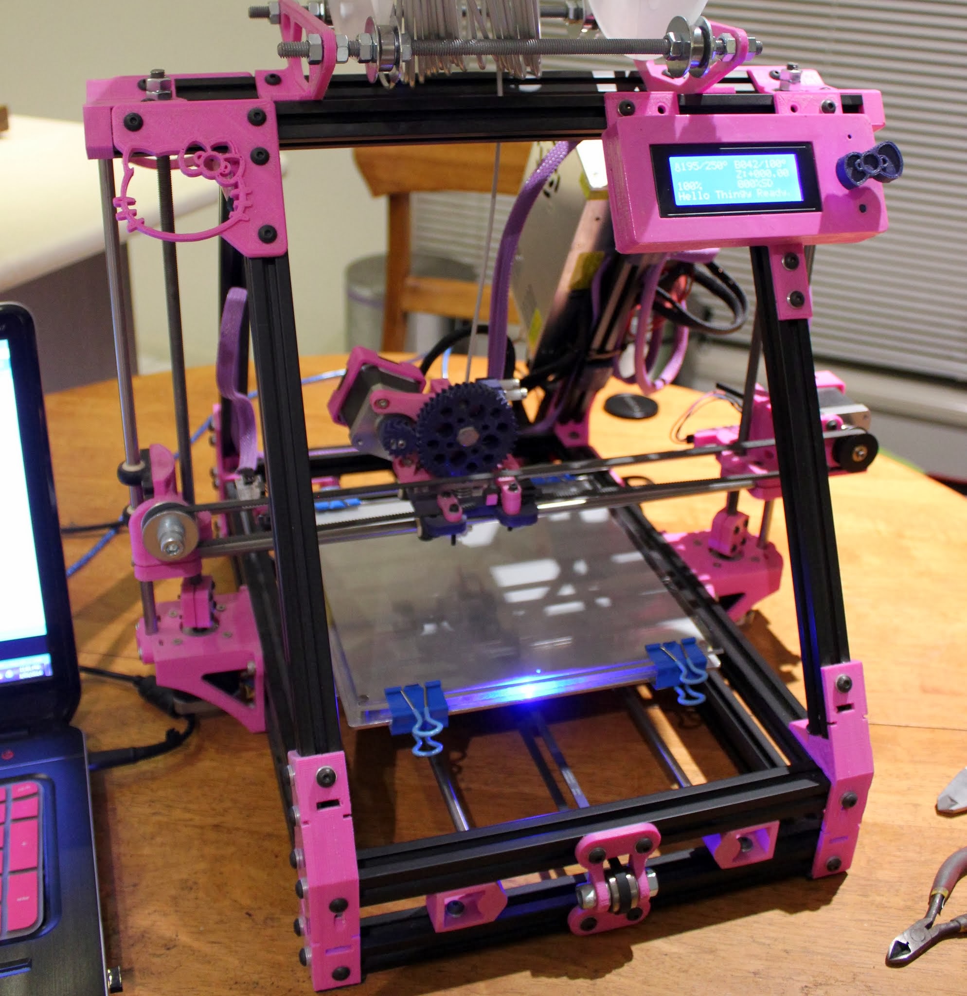

Just wanted to share some photos of my latest creation. Its a Hello Kitty Themed Mendel Max I have been working on, that I just got working tonight. Has some neat stuff too like the MKII Prusanozzle, and the new ALU heat bed.

What have you got for nozzle cooling there? Is that a 20mm fan? (They exist?!?)

wonderful; may I know how are named that black rods, and where may I buy them from (possibly not US) ?
That looks like Misumi’s black extruded aluminum.
Yes they are black misumi extrusions I bought from ebay
@Christopher_Benjamin yes, All the steppers have cooling, actually I will also add heat sinks. It gets rather hot in Australia and I run my machines 24/7 I make props as a side business so they only stop working when something goes wrong.
@Jarred_Baines the 20mm fan came with the MKII Prusanozzle. Its required to cool the top half of the nozzle as its all metal. No PTFE liner means I wont need to overhaul the hot end as much (I hope) My current MendelMax JHead needs to have its PTFE liner replaced after every 3 kilometers of 3mm filament has run through it, as it starts to cause too much friction after that.
@Ben_Van_Den_Broeck The loudest thing is probably the cheap $30 powersupply, which was a mistake, I should have bought a meanwell. It makes more noise than all the fans combined. And there are plenty of women into 3D printing, but I find most for a specific purpose, like me (I make and design props) not for 3D printing in its own right.
