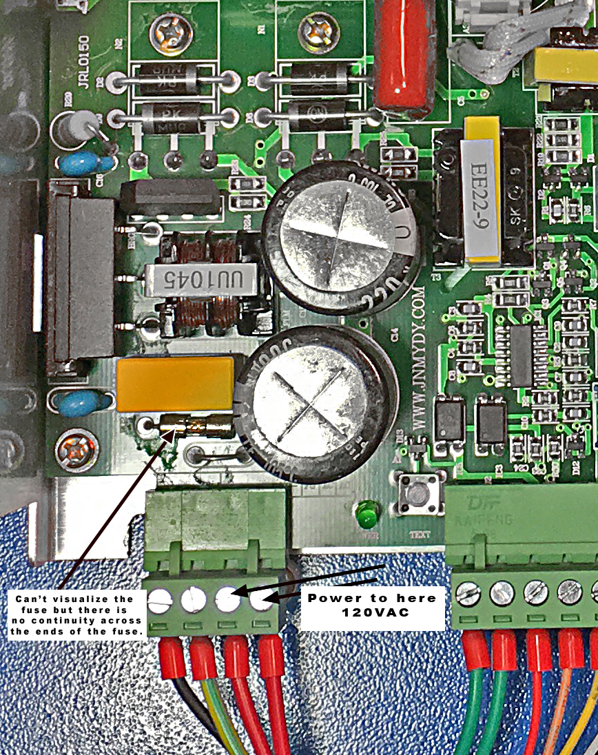

I’m getting power to the power supply but the power stops there. I see the fuse in the power supply on the board. Any idea on the rating of the fuse.
If the fuse on the power supply is gone, it went for a reason. Mostly it´s the bridge rectifier blowing up located a inch further in on the power supply board, check if it looks blown.
Also check the cables to the buttons, broken buttons and switches are pretty common on these machines.
I can’t see any burned or discoloration on the board. The fuse looks blown and there is no continuity when checked with VOM. Is there any wiring diagrams available? A blown fuse on the board would indicate other problems. I’m new to this and I might want to upgrade the PS and controller boars. Where should I look for these?

Clearly your fuse is blown (common failure) and likely due to a blown MOSFET, Rectifier bridge, power diode or flyback.
WARNING: these supplies are dangerous and can kill you. I do not recommend repair unless you are a trained on troubleshooting high voltages.
