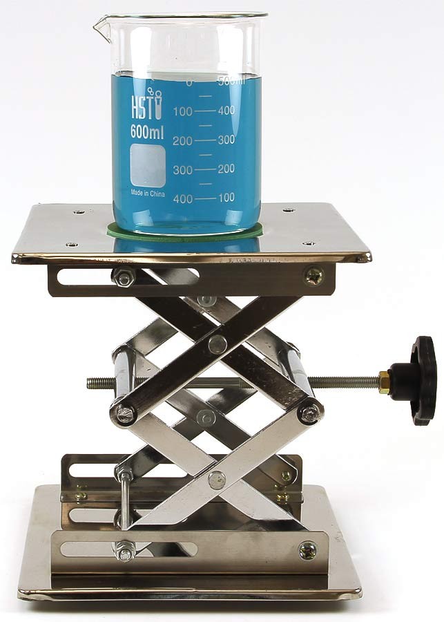

Just wondered if anyone has used a Laboratory Scissor Jack as a cheap adjustable
Just wondered if anyone has used a Laboratory Scissor Jack as a cheap adjustable bed mod (as they run about £20/$30 on ebay)?

@StephaneBUISSON The problem I’m trying to solve is being able to switch from etching and cutting acrylic/wood laminates (in themselves not a problem as my cutter head is adjustable by about 1/2", so its easy to adjust from say 0.8mm ply to 3mm Acrylic by moving just the head).
But, being able to drop the bed down to engrave on project enclosure boxes (I have had really good results engraving on powder coated aluminum boxes, etching the paint right off to bare aluminum) and being able to drop the honeycomb bed down a good couple of inches would be very handy, and looking to do it a little more refined then just wood shims between the base of the machine and the bottom of the bed. .

Yep that is what I used. It works great you will have to take one of the scissors pieces out to give you more depth but for 45 dollars vs 200 dollars it was worth it

@3D_Laser Good to hear it working out for you. I just ordered a 100x100mm one to play with, and see if I can make it a little more rigid with mounting a larger size plate on the top and bottom with some rods in each corner on some bearings (as I have some 3D printer parts here, I may as well use!).

@Pigeon_FX you might find that with the Jack all the way down its to high for the focal length mine was that big and I had to take it apart now I got a good 4 inches of play to hit that focal sweet sot
I got one a while back. You can unbolt to base and drill four holes and mount it to the bottom of the machine. Then remove the top platform and mount your honeycomb or perforated bed to it. It works well and I can lower it enough to accommodate all but very thick materials, but I imagine that would be the case with any platform.

I bought one to put under my rotary attachment. I will be cutting a hole in the bottom of the case and recessing the labjack and rotary so that I will have room for a decent diameter that I can engrave on. Without the mod, I can only do about 3" diameter
