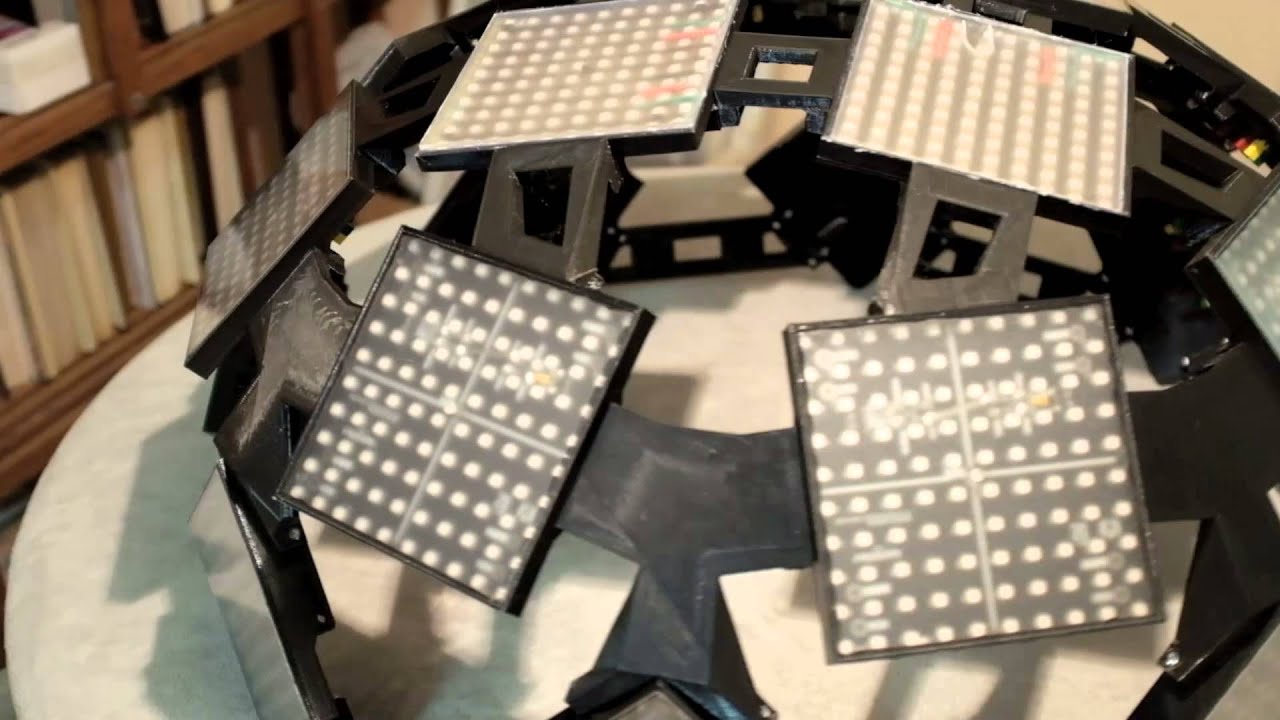

Just wrapped up an led art install project using a TON of 3d printed
Just wrapped up an led art install project using a TON of 3d printed parts, 3d printed led panels (utilizing some custom 10x10 APA102 pcb’s - Thanks @Steve_French !) teensy’s, fastLED 3.1, custom 3d printed enclosure, with animations driven from my favorite piece of software ever, Touch Designer.

Wow, how many hours of printing was that? That’s great being too create separate parts and assemble into a good sized display. Nice design.
The panels took a couple weeks of casual printing, as I was assembling as I went, but for the connectors like a week straight at the end.
I essentially arranged the 3d panels in a way that looked interesting, then modeled the connectors around the lay out. A lot can be done with even squares
