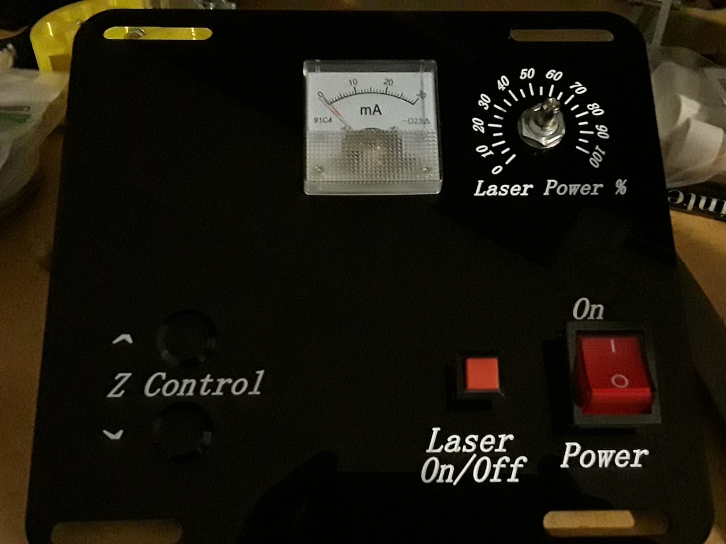

Here is my K-40 panel for now. I did not get all the parts in that I want to use but here it is so far. Nothing special. :smirk:
Nice. Are you using two tone acrylic or painting the engravings white?
Paint. Too poor to get 2 tone… LOL
Nothing wrong with paint, it’s what I did with mine. Used silver calligraphy ink, makes it sparkle a bit :slight_smile:

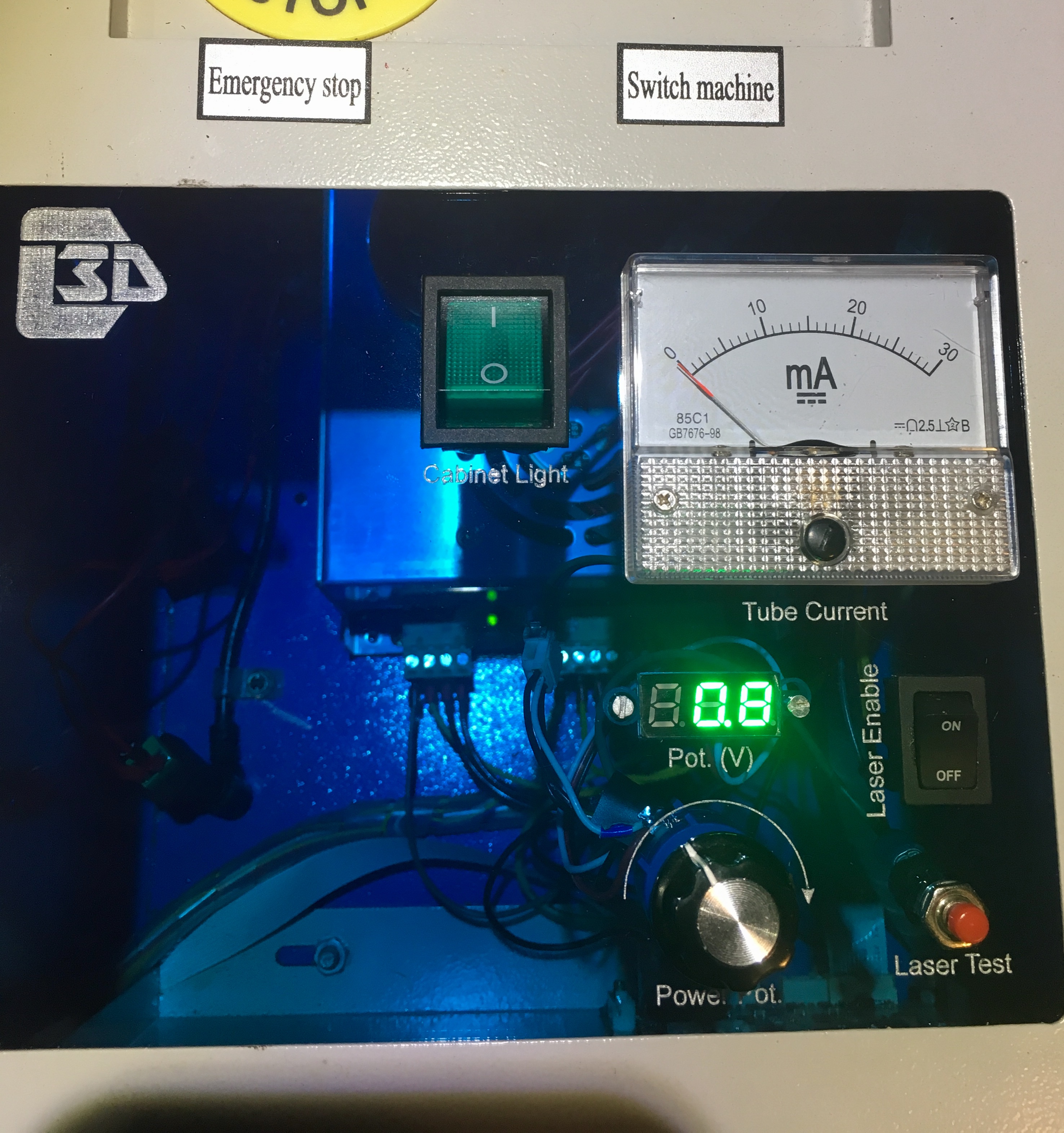

What is the Pot. (V) part and how is it connected?

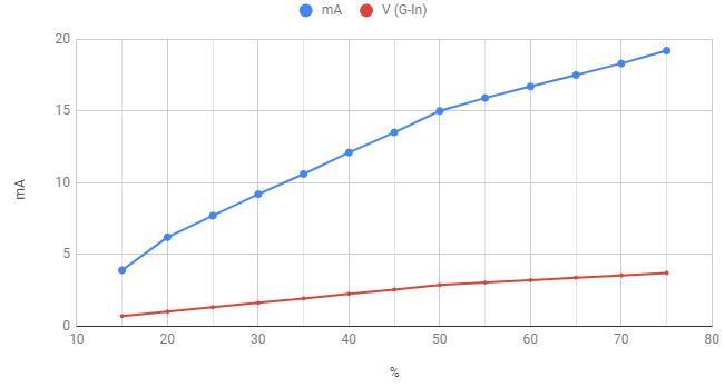

Ah, excellent question :slight_smile: That’s a voltmeter measuring the voltage between the In and ground pins on the potentiometer. The voltage is directly proportional to current so I can just turn the pot to a voltage.
More discussion here
Oh, ok. I have a bunch of those I used for vape mods :stuck_out_tongue_winking_eye:
Yeah it’s a 3 wire meter pulling off the 5V on the power supply to read voltages below 3V.

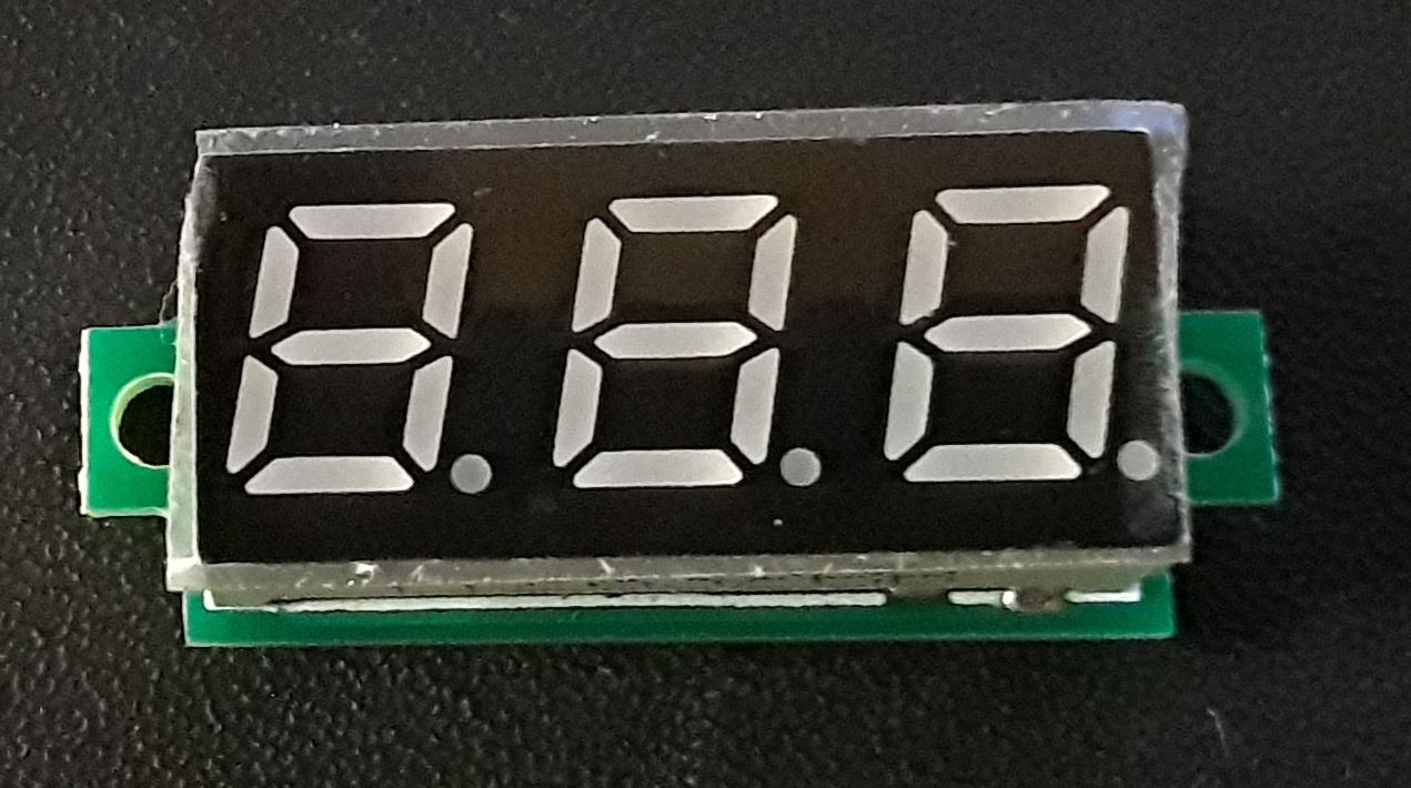

This is the style I have. No docs for it. Lol.
Gives you an accurate pot position by reading the IN voltage. This way you do not have to have graduations.
It’s a value of 0-5.
Here it is installed.
Looks good!
Very sharp nice job!
