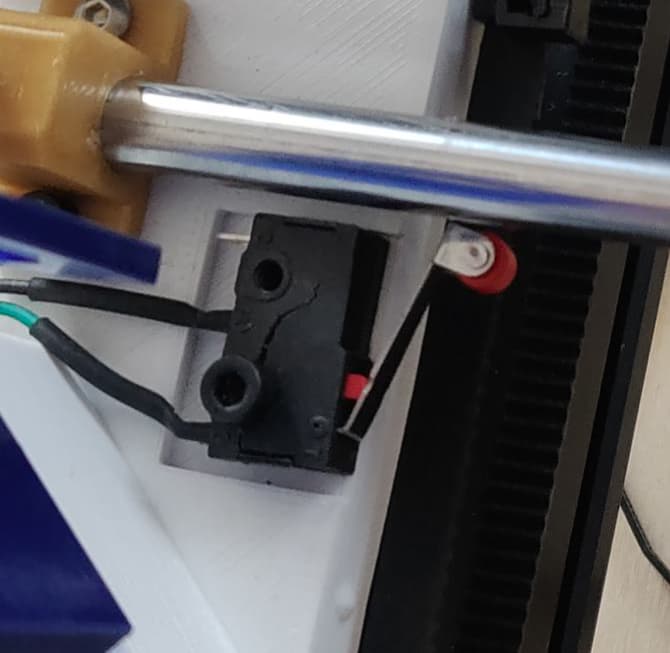

Is this X endstop working, note the crack!

I found the solution, with one of the reddit user. I will never look at this point…
The problem was … endstops where wired as NO instead of NC… after resoldering them gantry starts to move as it sholud…
As I saw on the screenshot on reddit, the official documentation (in Chinese) want me to solder endstop as NC. I thought that they should work as NO and that caused that weird move…
I figured that is was something with the endstop :)!
