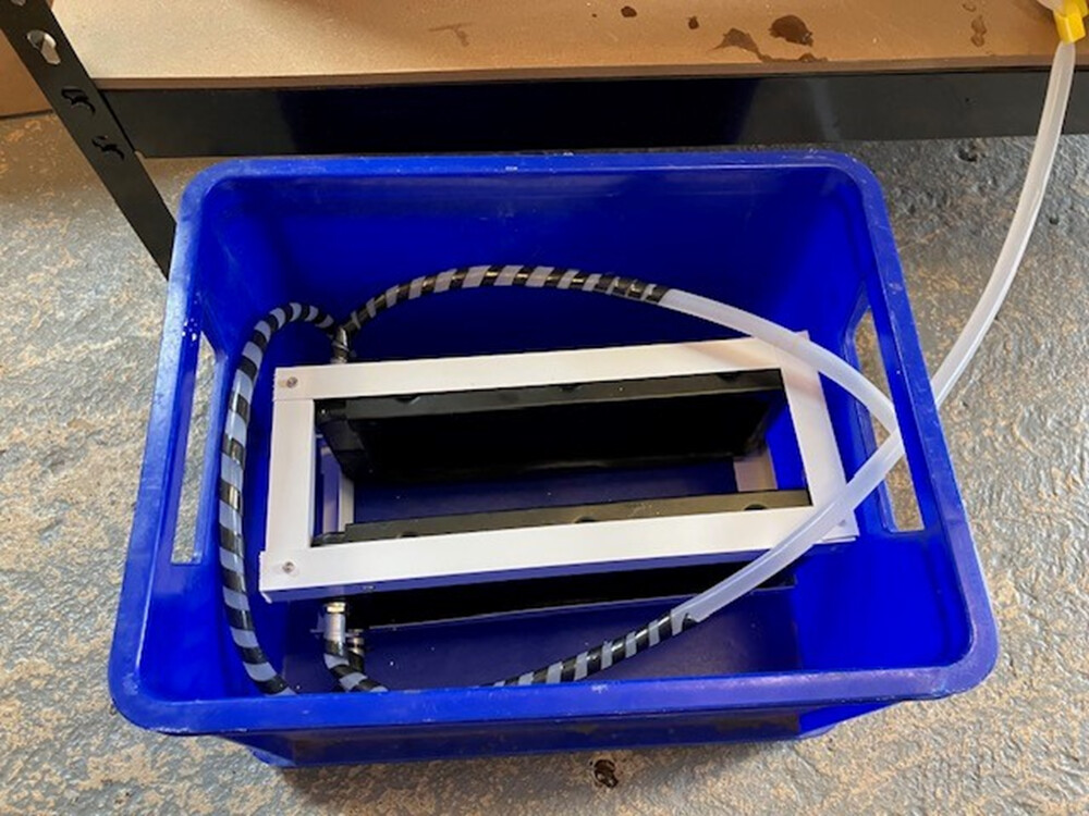

I have had some downtime due to problems with my LPS/tube so I decided to test out a change on my chiller by placing the radiators in a container of water sitting in my chiller as I just happened to have a suitable container that fitted perfectly. Although air chilling has been working well, I think that once down to temperature, water will have more thermal mass than air so may provide longer sessions.
The good news is there is still a place to store the beers!!
However, the results were not as expected, and the temperature has stayed stubbornly at around ambient 17.5C. Putting ice into the water did bring it down to 16C but rose again when it melted. I suspect the larger 20L primary tank sitting at ambient is actually pushing warmth into the secondary 10L water and even though the chiller is cold the water does feel warm so maybe it simply cannot chill the water.

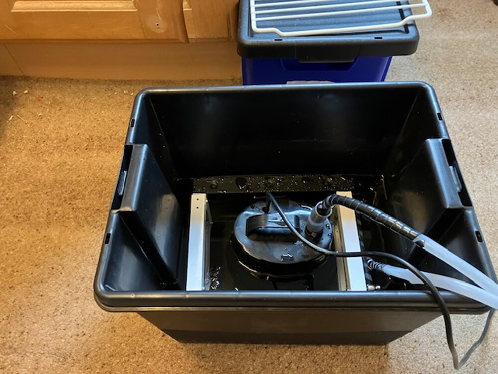

Yes, I take your point, but I decided to go to the third option whilst waiting for parts to fix my laser – put the primary system in the chiller. I could not believe my luck that my primary container just fitted into the chiller (no room for beers), and I could mount the radiators either side of the pump so the whole cooling system is sitting inside the chiller. Although I switched the chiller on last night, I had not connected up the external cooling circuit so the water was cold this morning. When I switched it on starting at 18C it moved to 9.9C in 20 minutes and the external tubes had heavy condensation at which point I switched off the chiller leaving the pump on and so far, it has only moved to 11.5C. I also noted that the flow indicator was spinning faster. In reality, I need to test with the laser dissipating heat, but it is likely that the cooler will more than keep up with the laser so I may need to add thermostatic control, but I can control manually for now. Am I right that laser operating temperature should be between 15C to 20C?

The pump is a Senelux SL-4000B: 4000L/H and 90W so yes it is heating the water so not surprising I was having problems before. The upside is that it takes in water from the bottom so could work in 2cm of water but I am not going to reduce the water in the tank. At some stage I will change it for my pond pump but the temperature bottomed out at 10C this morning so the chiller is keeping up. The acid test will be when I get the laser working and I have a cutting session but this fully contained cooling solution is the way forward so I will be sticking with it.
I did as @dougl suggested and looked at the spec of the CW5200 and although it is hard to work out how my chiller compares, what I did take from it is that a professional chiller also includes thermostatic control and protection against cooling failure. Last night I kept the pump on but switched off the chiller and was surprised to find the temperature at 30C this morning so yes the pump is heating the water even inside a cool chamber BUT this may not be a problem as I may need to warm the water in the winter and as I have already confirmed, the chiller more than keeps up against the pump with a steady state temp of around 10C. So, having gone this far I may as well finish the job and apply these additional features. I can source both the thermostatic control and a water flow sensor for not a lot of money so this is the plan:
