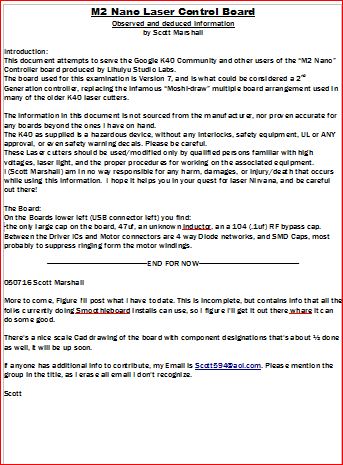

Anyway, here is what I have learned in the past couple days of dissecting the K40’s heart (Brain?) the M2 Nano Controller Board, Rev 7.
Here is a link to download the documents (Thanks to Halfnormal for making that happen)
If you have any information to add to my data, find errors, or just have comments, please send it to my email, and I will add it to the our “Reference Section”
I hope this helps out a few of you who are doing controller upgrades etc.
Nice idea. Thanks for contributing. One note on “Connector #4”, the flat FFP one. On my Nano board that’s the one used for the Y-axis control. The JST-4 connector you have for your Y-axis is not used on my Nano board.
Not sure why sometimes they use the JST connector and sometimes the FFP one. Maybe a difference in which factory uses which kind of cables.
Your da men @Scott_Marshall ​ good luck
@Jim_Hatch
Double checked, Thought maybe I just mixed them up - It happens after you stare at a board long enough. Mine has the flat cable tied to what is marked the “X” JST, it’s the one directly adjacent to the FFP connector.
Maybe they have the board silkscreen wrong? It could be they have the JST Y(marked) connector hooked to the X axis.
It makes complete sense that they would run the Y thru the FFP cable as it’s the moving motor, while the X is fixed.
I need to go look at my chassis to see how it was connected.
The only other thing I can think of is maybe you have a different revision?
Once I figure it out, I’ll note it on the table. Rev A! Didn’t take long.
Thanks for the heads up, Good catch!
