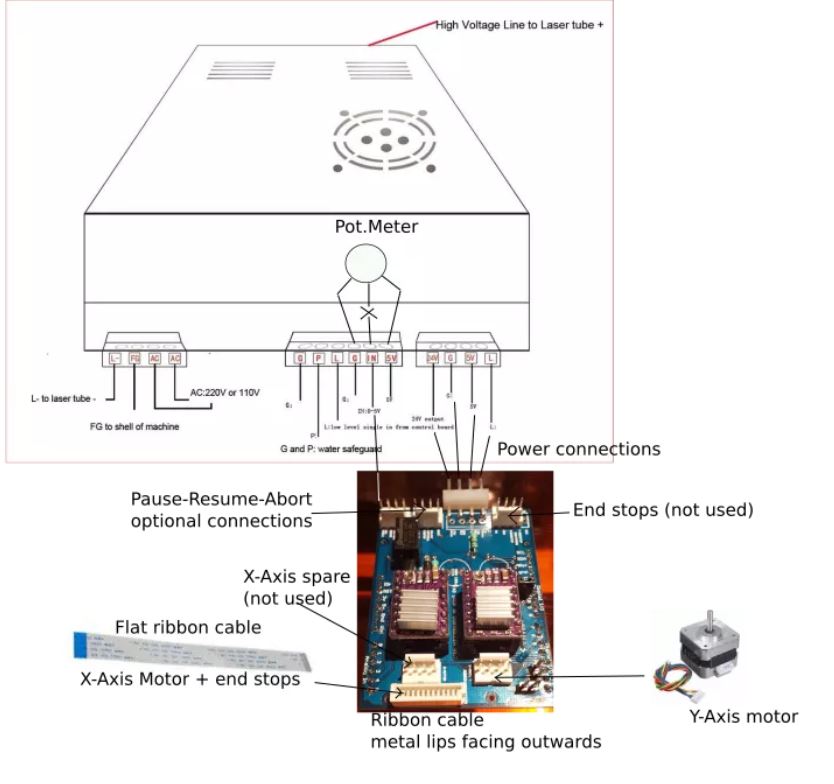

You are both correct as it relates to the Original K40 controller and some other controllers, but as I stated it is in fact the setup for original Gerbil (newer Mini Gerbil may be different). Here it is from awesome.tech website and is recommended setup by Paul based on his original design and may have changed for Mini Gerbil.
Yes, it is also that way for the miniGerbil. Paul at awesome.tech has always used the IN terminal for PWM control.
Reset

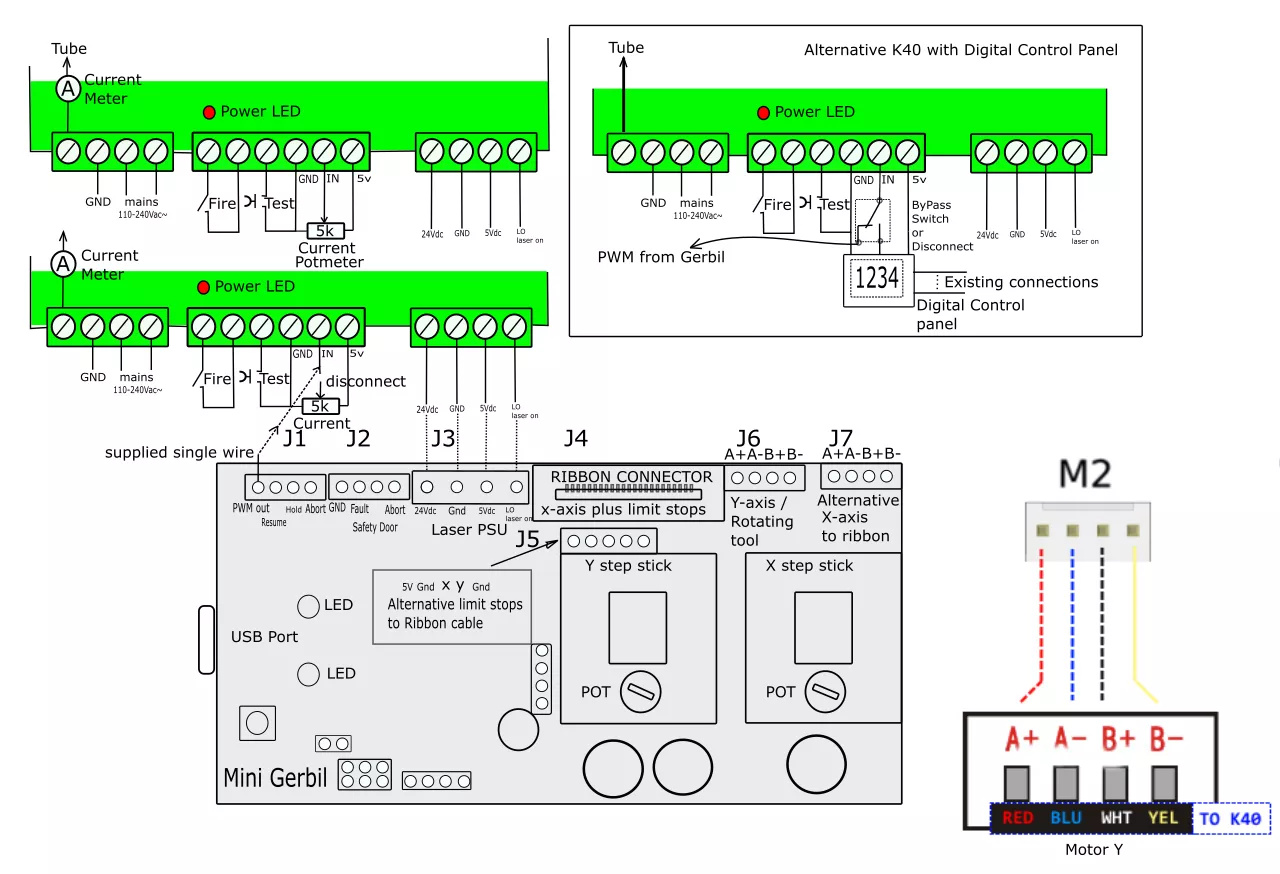

From Pauls @paul website this diagram shows how Paul is recommending connection.
In this configuration I interpret that:
  • the L pin provides on-off control (enable) of the laser.
  • the IN pin controls the power via a PWM signal
Since both L and IN control the PWM characteristics of the LPS this configuration will work fine. [this statement is not exactly correct but good enough for this discussion].

Unlike smoothie boards the mini-gerbil PWM output can drive the IN pin directly as it is 5V logic. For smoothie boards internal 3v signals cannot. This is the reason that smoothie configurations are best implemented using the L pin driven from an open drain driver. The control of the lasers on/off can be implemented using a driver mosfet & relay in the interlock circuit configured as a switch.
The only disadvantage of this IN pwm approach is that you loose the manual power control pot. However you gain simpler and auto-magic programmatic laser on/off control.

Note: the diagram above show how to implement a remote-local switch for the pot or digital control panel.
@donkjr, thanks for the updated diagram. As I said earlier, I know that you’re an expert on these machines, but the gerbil setup may be a little different in this area. You and @cprezzi may be recommending a better way to connect, but it’s likely @Badlaser43 is having problems with the default installation. Also what is the L pin, can you identify it in the diagram posted above???
Per the gerbil standard installation posted above I verified that anytime the gerbil PWM is connected to In on the LPS the test button on the panel does nothing. When you disconnect the gerbil from the In on the LPS, the test button on the panel test fires at around 10mA (this is with the sweep leg of the pot disconnected and nothing is connected to In of the LPS), when you connect the sweep leg of the pot to In of the LPS, the test button on the panel fires according to the setting of the pot (from 0mA to up to 18-20mA).
So I think the advice to disconnect the gerbil PWM to get the Test button working may also apply to the mini-gerbil in question.

Sorry, the L is actually the LO pin in the diagram above.
I will go back and look at the LPS and min-gerbil schematics to see if I can explain the behavior that you verified when connecting/disconnecting the PWM to the IN pin as you suggest
Behavior #1: Perhaps when the PWM pin is connected to the IN pin it is holding it to ground until the PWM is asserted. If this were the case the TEST button would fire at 0 power and therefore look like it did nothing.
Behavior #2: When you disconnect the Gerbil PWM from IN the test panel fires at 10ma. At what level will the LPS fire if IN is left floating? Perhaps it is maxpower/2 = 10ma.
Both these behaviors is IMO further reason to use the method I outlined :)!

When neither the pot nor PWM are connected to IN pin of the LPS and IN is left floating I get 10mA, When I connect the sweep leg of the POT to the IN pin of the LPS, the pot controls the power from 0mA up to around 20mA- I don’t run it that high… ever.
As far as connecting PWM to LO, you could be correct, but I will consult Paul just in case he’s doing something unexpected. Once he confirms I’ll wire it up that way and report back.
