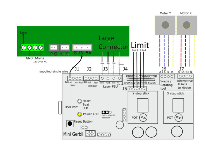

The brown wire is something I added when I was trying to install the Mini-GRBL. Here is a picture from AWESOMETECH’s page. The “IN” is where the brown wire is going. There used to be a connector on the end of the white wire and when I was trying to install the Mini-GRBL I pulled the connector off. When I couldn’t get the Mini to work, I added that wire to hook back into the IN. I am going to try again this week.
The problem last time is that I wanted to keep the digital panel working (my fault) and didn’t realize that with the Mini-GRBL installed Lightburn controls the power. They didn’t have this image when I tried to install it (I think).

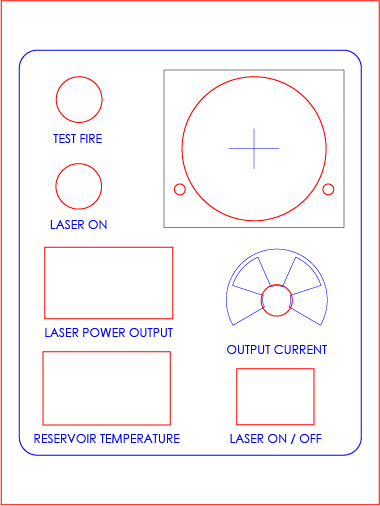

If you have something I can modify in Illustrator or SolidWorks. All I want is a mA, Power On/Off Switch, Laser On/Off, Test Fire and Tube Temp and Water Temp. I will post what I have designed in a bit
Here is the design I made and I think it will work. The blue box is the size of the opening that the current digital panel.
