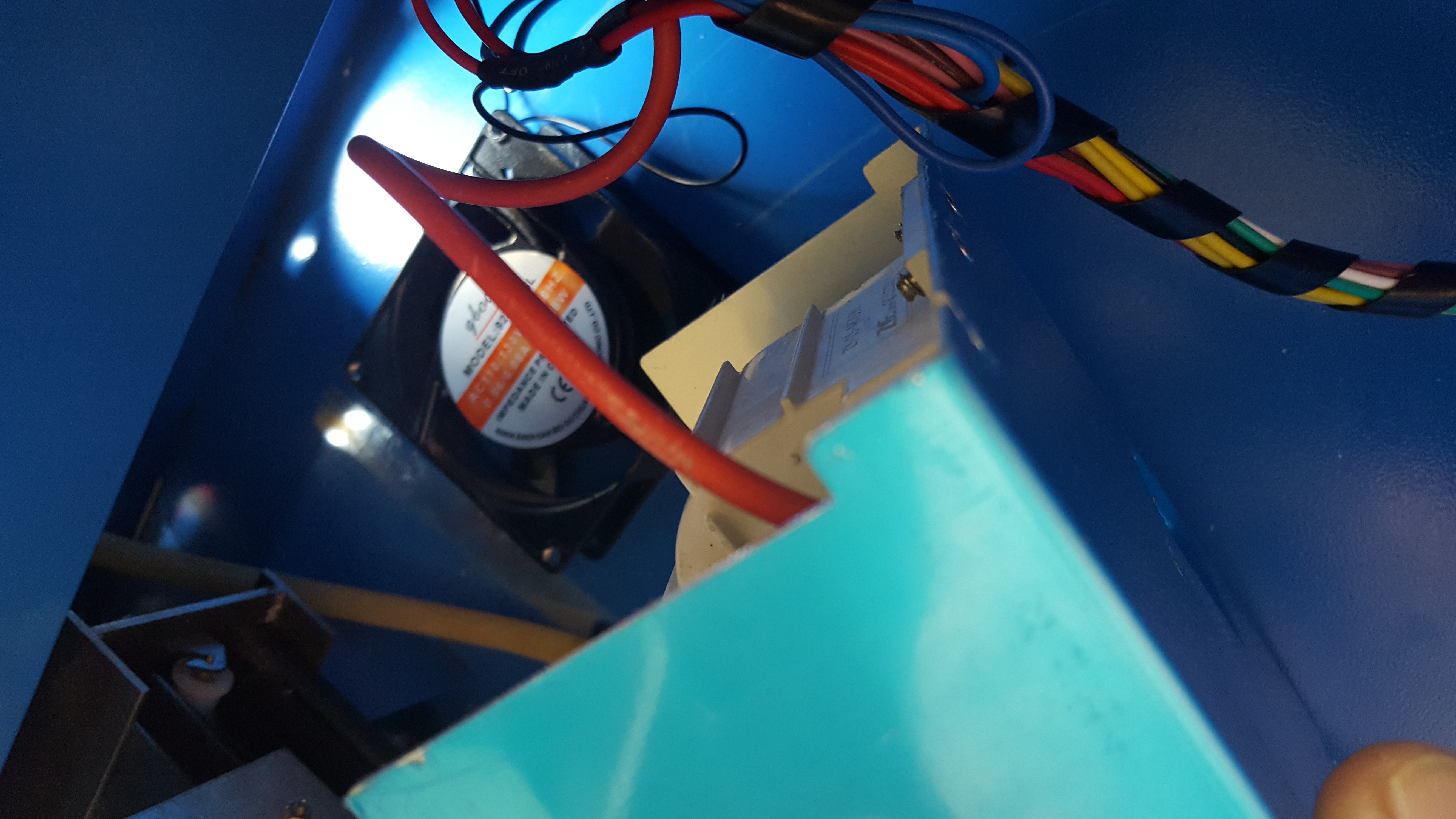

1). The high voltage wire has some chaffing where it comes out of the back of the PSU, due to the aluminum base is real rough.
2). The high voltage wire will now be to short so I bought 6 feet of new high voltage wire with connectors from amazon.
I was originally going to splice in the wire just after the flyback and add the length I’d need, but now with the chaffing, I would like to remove the high voltage wire from the flyback.

The High Voltage connection is potted into the HVT. I would not recommend removing it.
What supply do you have, show a picture of the problem area?
I thought the standard supply cover does not encapsulate the HV output??
Add a grommet or some plastic grommet material to the edge it is chafing against?
Just add a connector or high voltage splice to the pigtail

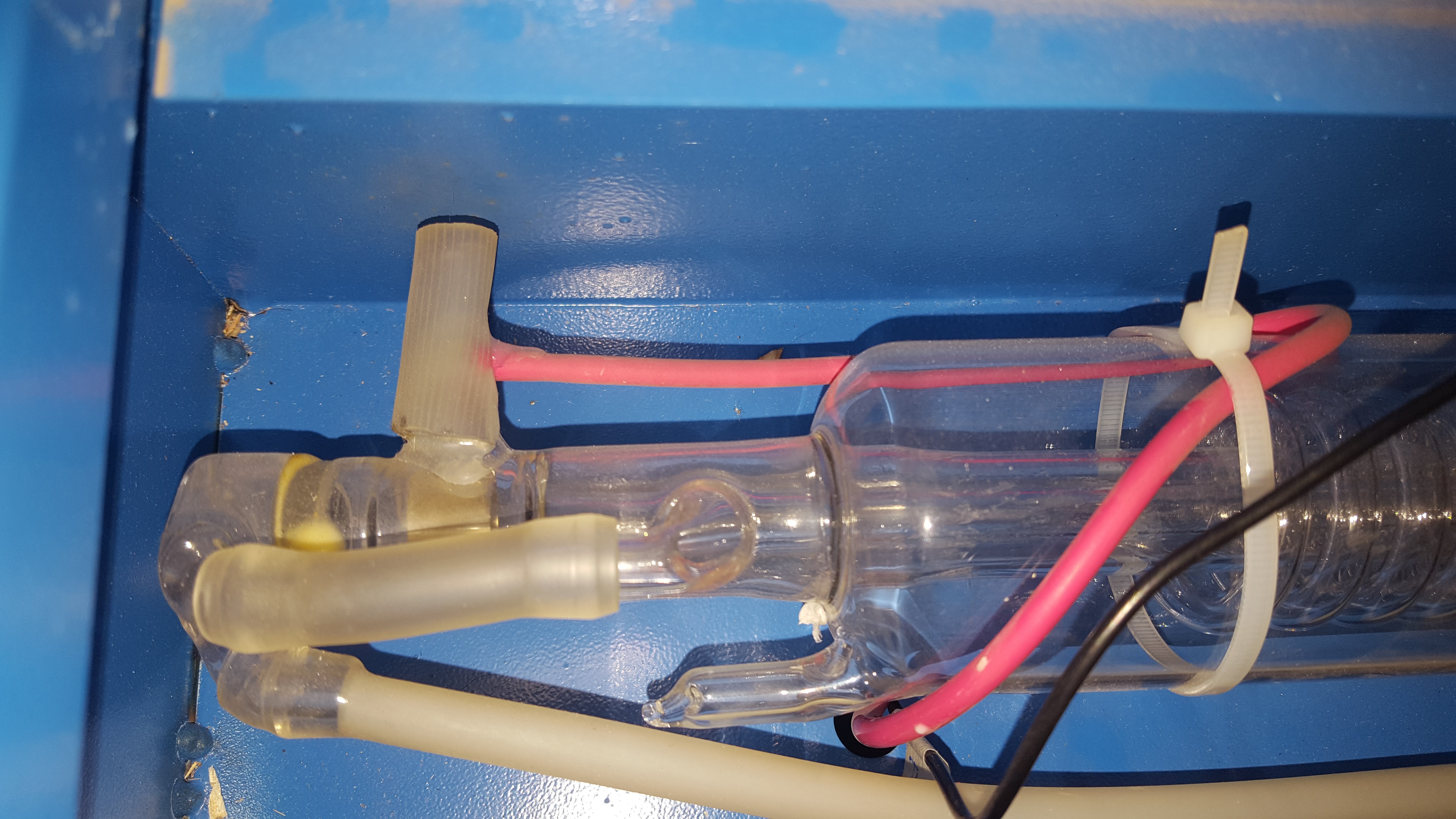

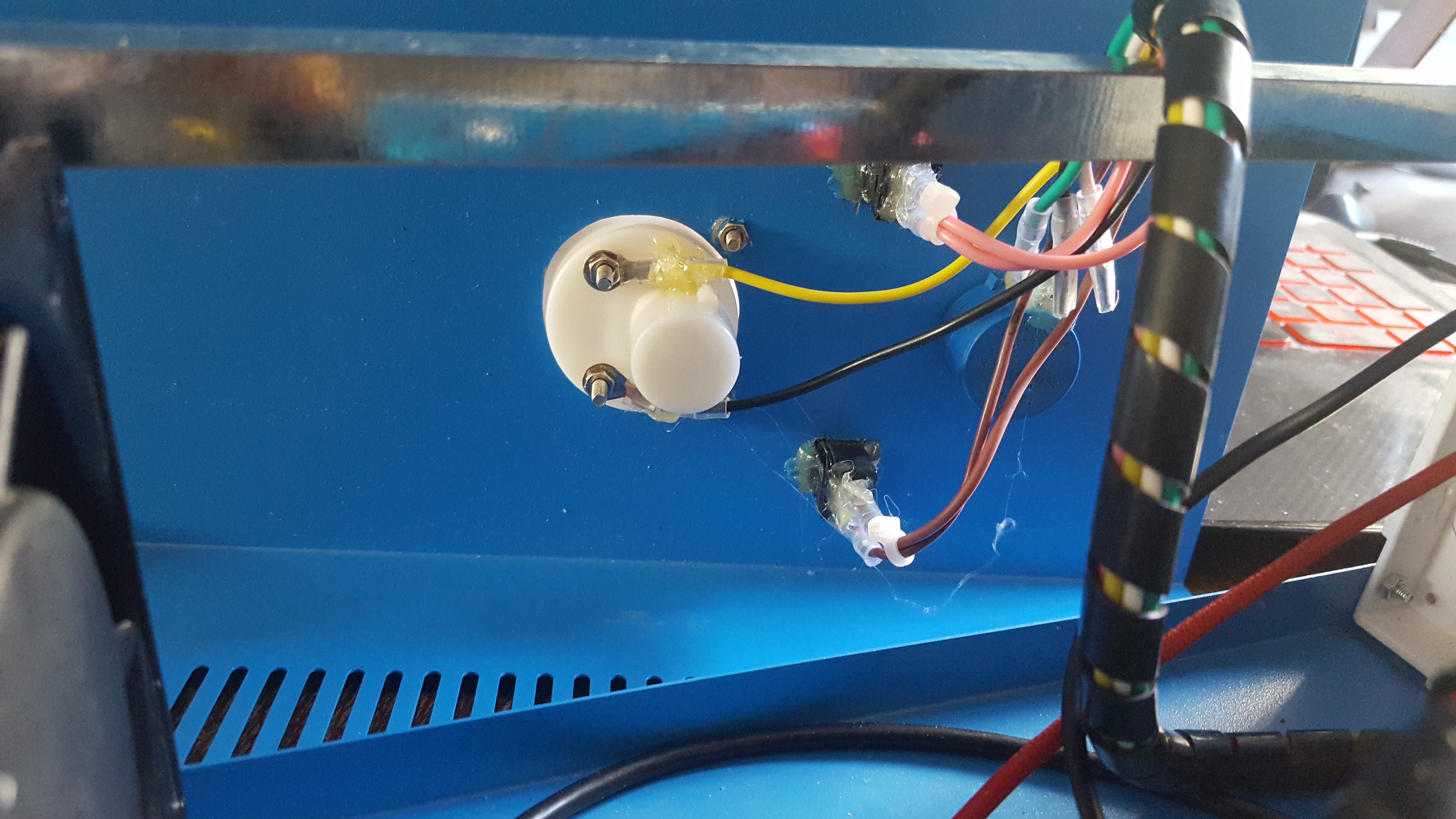

The chaffing doesn’t look as bad at it is in the picture and is where I will do the splice. I would solder, wrap with a few pieces of shrink tubing then slip a section of the silicon water hose over that to prevent arching and any further chaffing. I could easily replace the hose if needed.
Here are a few pictures.
Regards
Bill
I would put this on the edge of the LPS:
https://amzn.to/2Fwn7kq
… and then add the connector to the HV wire making a pigtail as far away from the enclosure as is practical.
… if you make a splice also do it as far away from the enclosure as you can. This voltage can jump up to 2".
If you splice use Permatex Blue RTV and make the tubing diameter as large as you can then fill it with the RTV. Make the tube overlap 1" past any open-wire surface.
When you solder the joint use “Ball Soldering”. You don’t want any sharp points in the soldered joint.

Is your HV cable exiting the electronics box and then entering the box with the laser?
I would be nervous about that being outside where a human can access it.
You know that that cable runs 20,000v right?
If it runs outside I would fin a way to enclose it …
I strongly urge you to add interlocks to both sets of covers, the electronics, and the laser compartment.
You also should include water flow and water temp sensor into that interlock circuit.
Hi Don,
Yes, the HV cable will leave the electronics box and run behind the laser along the wall. It will be 100% enclosed within a silicon hose the same kind as they put on the laser tube connection points. There is no possible way it can be accessed unless you move the laser enclosure. A few things left to do, like shim the head, drill and mount #1 mirror, lengthen the stepper motor wires, mount the limit switches, connect the HV wire, and splice the - (neg) wire to the tube. Also, add a ground wire connecting the electronics housing to the laser housing, cover some of the openings in the back of the laser enclosure, adjust the tube alignment, and then fire it up to align the mirrors. I have all new mirror mounts and head, along with mirrors and a new lens.
I’m almost at the end of the tunnel.
Once you get this built I would test the shielding on the HV cable.
Lay a ground wire next to the tube and pulse the laser in the dark to see if you get leaks.
I don’t see interlocks on your list of to-do’s :frowning:

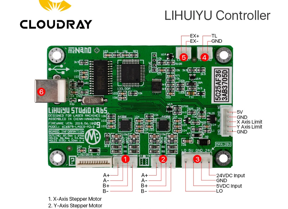

I have a question about the limit switches. I am ditching the ribbon cable and optical limit switches and am using mechanical micro switches, as shown in the picture. I have two on the Y-axis, front and back, and one on the X-axis on the left side. I am also using the stock M2 Nano board with K40Whisperer and testing Meerk40T software. I want to plug in the X and Y-axis steppers into their respective plugs and use the 5-pin connector to limit switches, as shown in the M2 Nano board picture. I think I understand the 5-pin connection to the board for the steppers, but I am wondering If I leave the 5v at the top of the plug labeled NC alone?
Also, would the micro switches’ connections be in the open or closed position, as shown in the switch drawing?
I have included a picture of one of the switches I am using.
I have six different colors of 22g stranded silicone wire for the steppers coming in tomorrow to extend the stepper motor wires, and I already have 50’ of 26g 3-wire for the switches. I’ll peel one wire off.
Oh, I almost forgot, what is the voltage of plug #5 in the picture of the M2 Nano board?

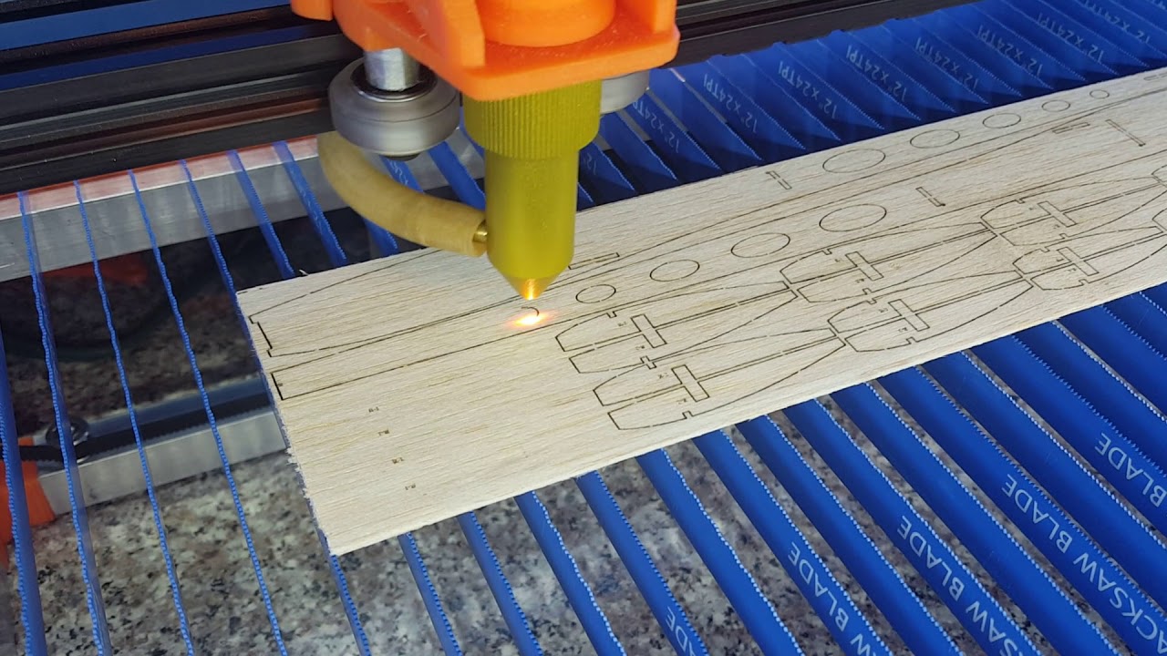

I’m happy to report that the laser is once again alive. The mechanics work perfectly, but I could tighten the X-axis belt a little bit.
I ditched the ribbon cable along with its optical switches and daughter boards on the electrical side. I added four limit switches, one at each end of both the Y and X-axis, and they work great. They are wired straight into the 5-pin plug, as shown in the picture I previously posted. My only issue with the wiring is that when plugged in, the power switch is always glowing even when powered off. I need to switch the red common and line wires on the button, which should solve that.
The laser tube works perfectly, and there is no arching anywhere in the circuit. Right now, I am currently aligning the mirrors. It takes a little more time than a stock K40 due to being a little larger, and it’s a bit tighter to work on the 1st and 2nd mirrors. I probably should have bought the alignment tool from American Photonics for simplicity, but I’m a patient guy with time on his hands.
My actual movement came out to be:
X-axis 607.009mm (23.898")
Y-axis - 260mm (10.236")
Here is a couple of videos showing the first homing from the heads farthest position, and one of it simulating etching. There is a little vibration in the X-axis due to the belt being a little loose.
Homing testing the limit switches
Engraving movement test
Once I get the mirrors aligned, I’ll post a video of the machine at work.
