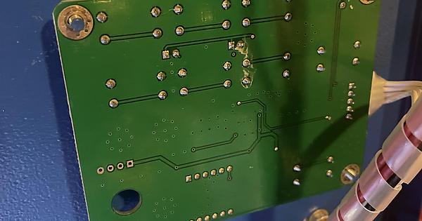

Here are the photos:
there are a lot of clamps but that’s so we could rebuild from smoothie to nano faster. (this worked also when we rebuilt it once) everything is connected back to the same wires as before, just with clamps between., All other 5V-stuff is orking (LED, laserpointer).

I did not mean the PCB but the actual front panel and then the wiring from the back.
Also, include the other photos requested.

It acts as if the 5v to the control panel and/or ground it messed up.
I would check panel voltages relative to the ground on the LPS.
Reverify wiring with an ohmmeter.

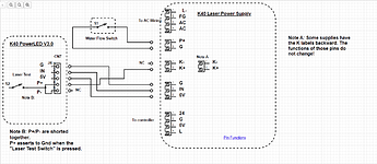

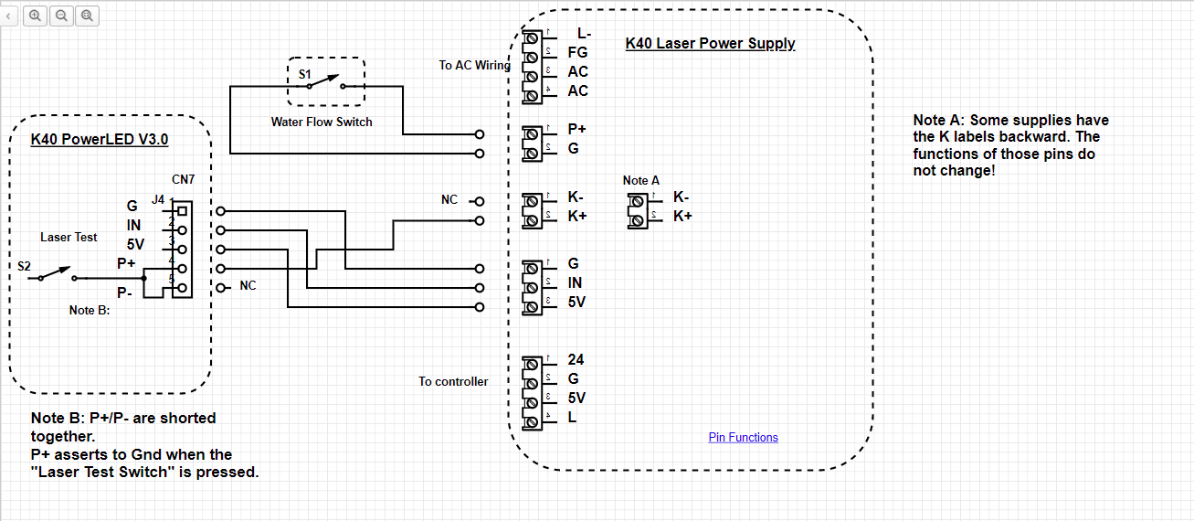

Here is how it should be wired.
It’s wired exactly like that, also reverified with an ohmmeter, all good. The voltage from panel relative to ground on LPS shows 4.25V

The 5V supply should be closer to 5V that suggests to me the panel is over loading the supply.
If you unplug the panel does the 4.25 go closer to 5V?
If you got something like a lab bench power supply, take the panel out of the machine and see if it powers on if you hook up G and 5 V.
I just did that with mine (PowerLED 3.5). It draws about 30 mA. Like a caveman, I used female to female DuPont cables to connect to male to male DuPont cables in order to connect the alligator clips to the two pins of the JST connector. What a janky setup. Lol.
A replacement panel costs about $10. (Not all of them have that on/off button in the top right.)
Alternatively, replace it with a potentiometer, a momentary switch, and a (3-wire, 4+ digit) voltmeter if you want some kind of readout for the power value. While you’re at it, I recommend to install an ammeter if you haven’t done that already.
