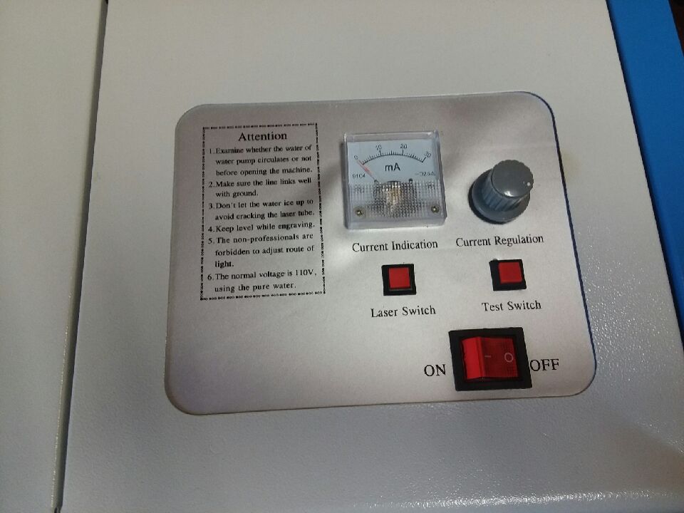

Please post a picture of:
  • Control panel

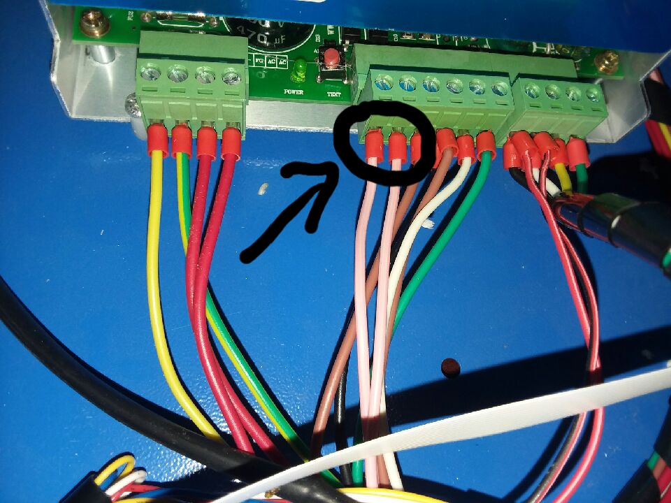

  • Laser Power supply input connectors
Hi, yes I tried the red test button on the LPS and it still won’t fire. I am including the pictures you ask for.
Can you see where these two wires are going? Maybe a water flow sensor?

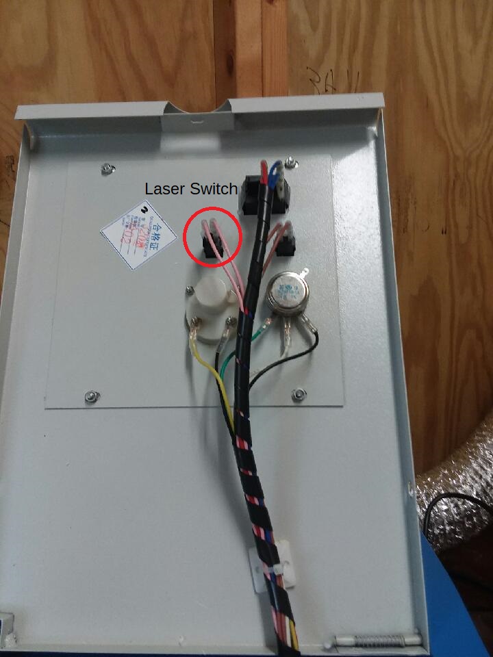

This may sound obvious, but I would check this switch is working.
So with the power off, either check it with a multi meter, or disconnect it from the power supply and bridge the gap with another piece of wire.

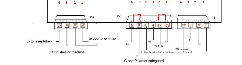

On the LPS:
  1. The green LED should be on if not check the input AC power
  2. Check the 5V output with a DVM.
  3. Check the 24VDC output with a DVM
For reference (ignore the Red lines for now)
