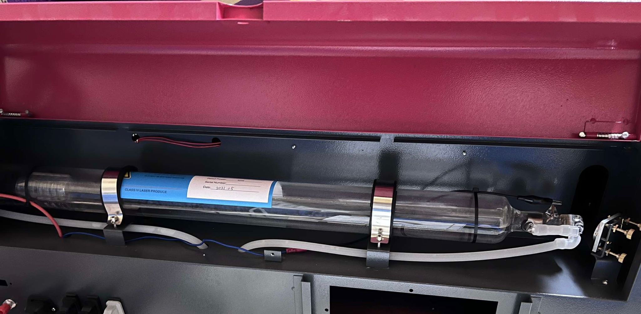

Hello, I bought a Chinese laser machine from alibaba, and when I tried to test the laser it was not working. I tried to do the engraving using K40 Whisperer, but the laser was moving but not firing. Tbh, I don’t know much about laser machines and I don’t know what to do, I took a few pictures from inside to see if anyone knows what is the issue.

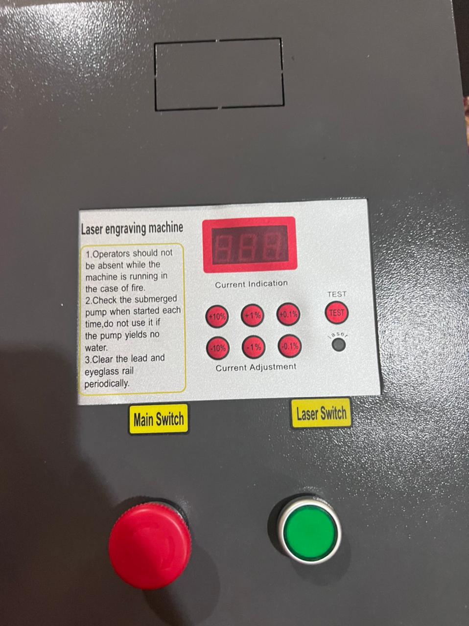

Please post pictures showing
-Laser power supply connectors
-Control panel

This is the control panel
Can you please show me what the laser connectors looks like.

What test button did you push? The one on the control panel or the one down on the LPS.

Thoroughly check the tube for cracks in the glass. Is there any?

The tube is in perfect condition, here is a picture

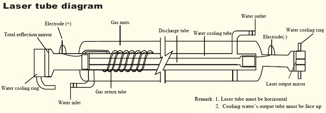

Sorry to say this but the tube is broken… There should not be water in the outer portion of the tube(large diameter). Either it was fired without water or water running or it was broken in transport.
I couldn’t find any crack on the laser tube tho, what may cause this problem?
Thank you

The tube may have been shocked while in shipment and the damage (crack) may not be easy to see.
