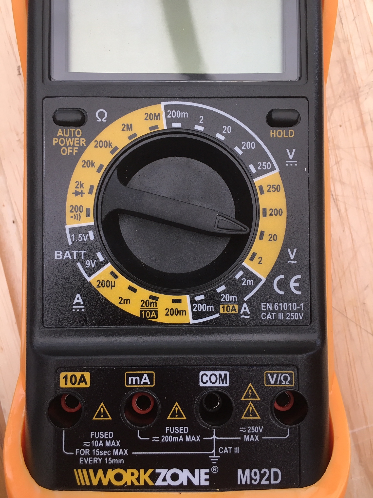

Do you have and know how to use a DVM?
DVM ?
is that a digital volt meter
I have a reasonable understanding of how to use a volt meter
Yes DVM = digital voltmeter

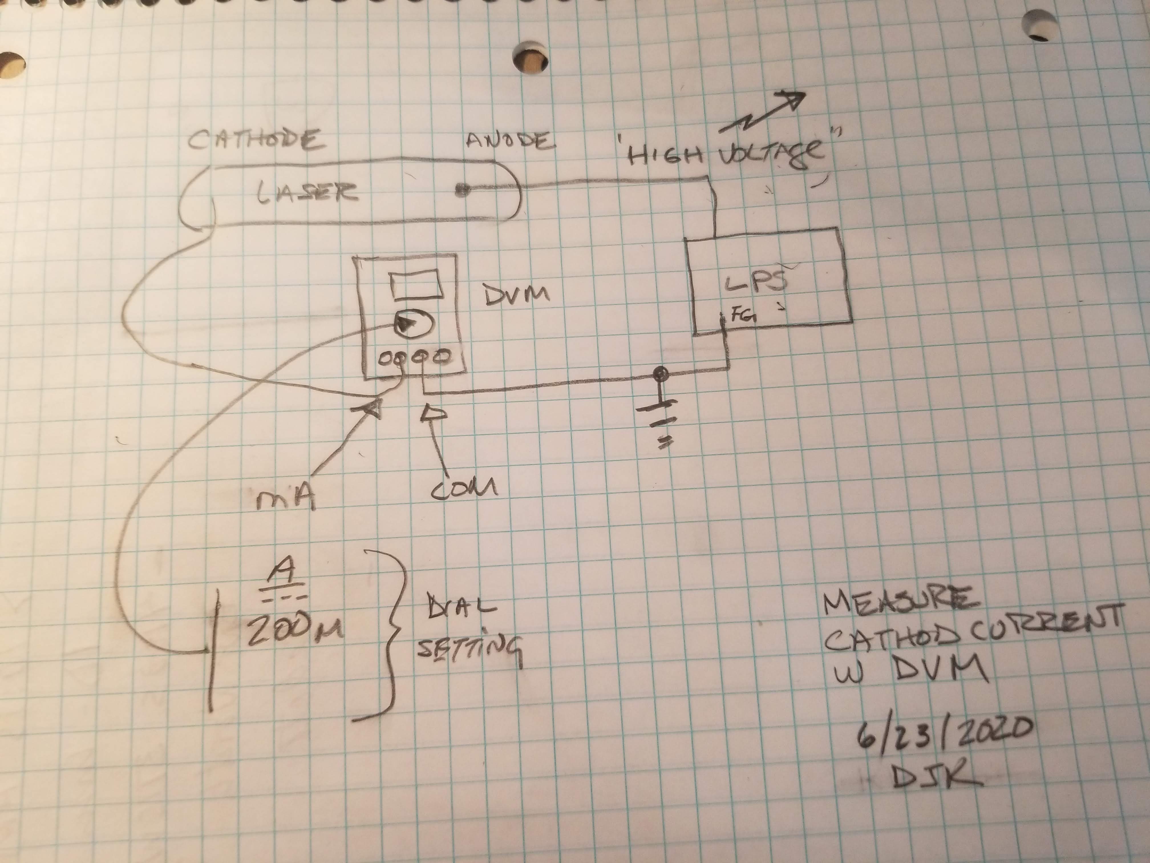

Ok I will send you a sketch for measuring the current in the tube.
Can you post picture and model number of the DVM.

The attached diagram shows how to connect a DVM to measure the current in the tube.
Summary of the measurement
The tube’s anode is connected to the HV side of the LPS (stay away from this end)
The tubes cathode (the other end of the tube) is connected to ground at the LPS.
The cathode wire is typically green and connects to the FG pin on the left-most connector of the LPS.
We are going to put the DVM in series with the cathode side of the tube and ground and measure mA.
Setup the measurement
  • Disconnect the green wire at the LPS and connect it to the plug labeled mA on the front of the meter.
  • Connect a lead from the COM plug on the meter back to the place where the green wire was connected on the LPS. This should be FG on the leftmost connector of the LPS.
Set the dial on the meter to the DC amp scale (has an A with a dotted line under it).
The meter should read the cathode current in milliamps typically between 0 and 30.
Map your current output vs the % set on your digital control panel.
  1. Set the control panel power to 10%
  2. Close all covers, enable laser
  3. Push and hold the fire button and read and record the value on the digital meter
  4. Increase the digital setting by 5%
  5. Go to step #3
You will end up with a table like this
% power setting tube current
10 xxxx
15
20
25
30
35
40
45
50
55
60
65
70
75
An example table is here: Don's Laser Things: K40 Laser Power Supply
[ignore the rightmost column]

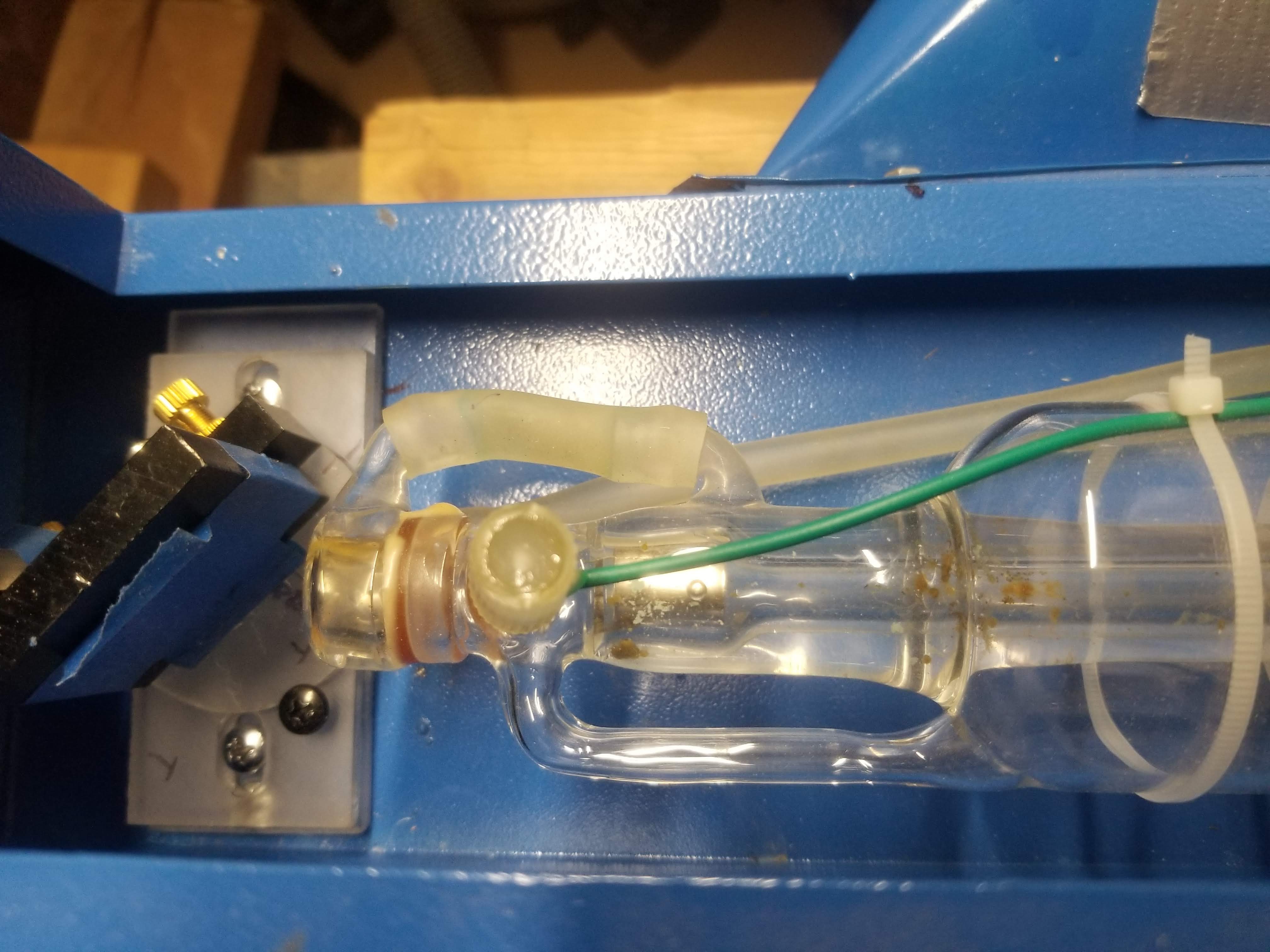

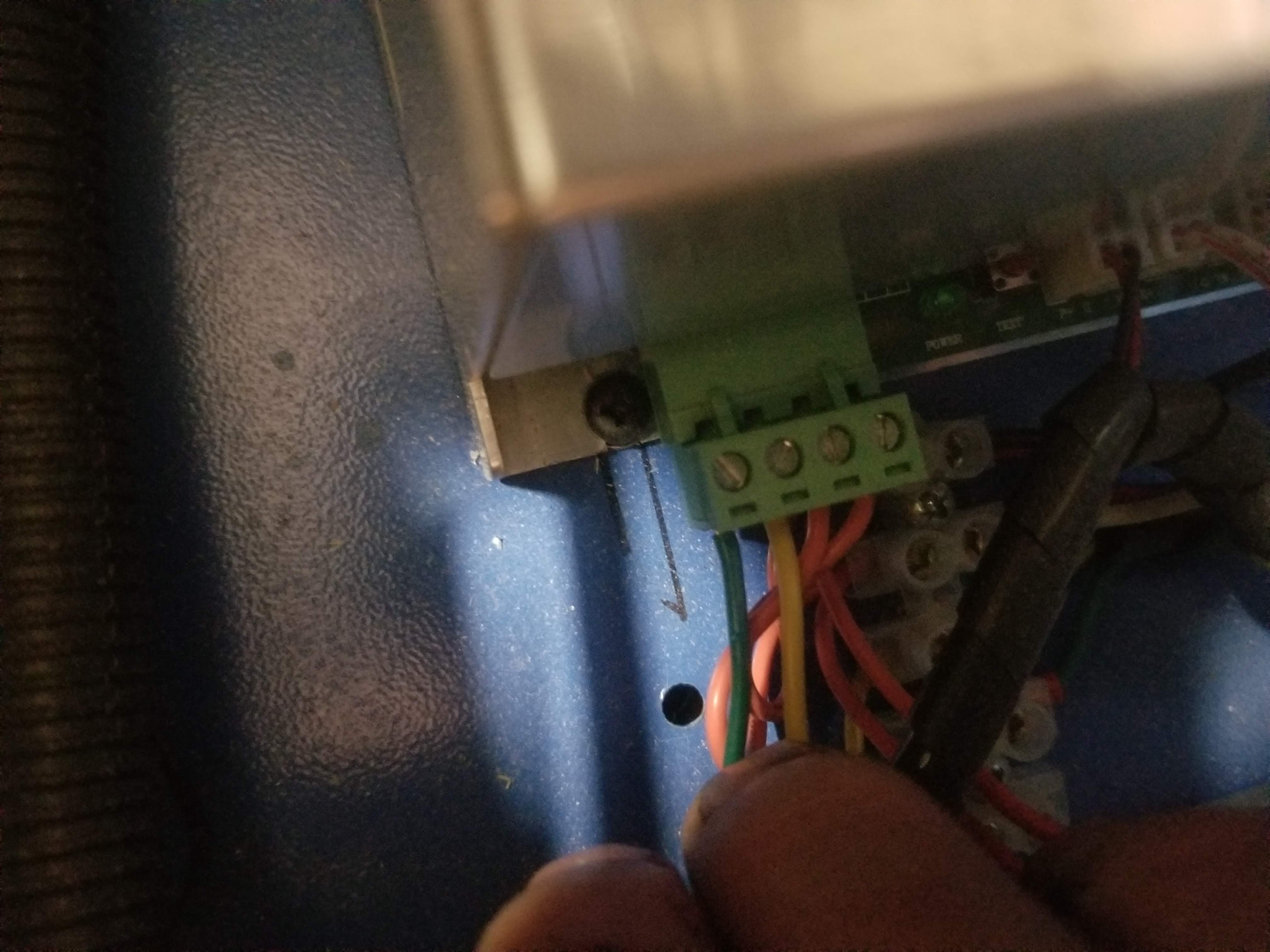

Cathode wire at the LPS:
Cathode wire at the tube:
OK great instruction , very easy to follow.
Your green wire is black on mine

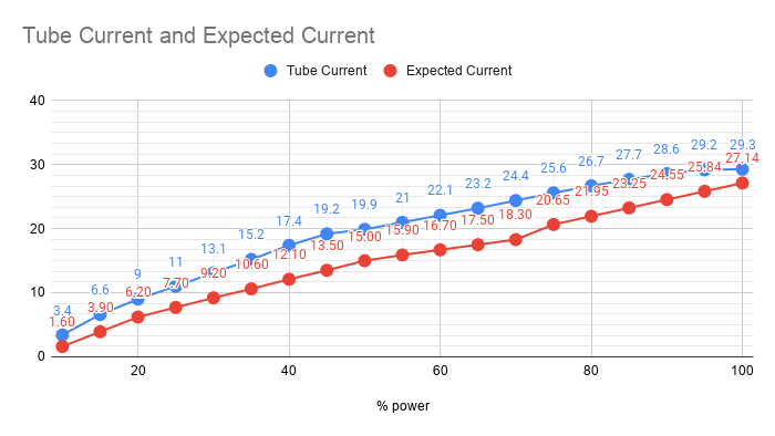

readings as below , I did notice once I went over 70% there was no laser emitted
% mA
10 3.4
15 6.6
20 9.0
25 11.0
30 13.1
35 15.2
40 17.4
45 19.2
50 19.9
55 21.0
60 22.1
65 23.2
70 24.4
75 25.6
80 26.7
85 27.7
90 28.6
95 29.2
100 29.3
The LPS seems to be putting out more than enough power.
The % power vs current is pretty linear meaning it isn’t shorting or arching-over as the demand increases.
There is no simple way of eliminating the tube vs the LPS other than an expensive and dangerous high voltage measurement.
However, these symptoms suggest the LPS is good;
  • Usually, when a LPS is bad the output is erratic at high power %'s. This does not show that.
  • The tube can and does draw full current
  • There is no evidence (sight or sound) of arching at high power demands
Hints the tube is weak:
  • The supply puts out full current but the light output is weak
  • This tube dies at 70% with 24ma of current and no arc-ing.

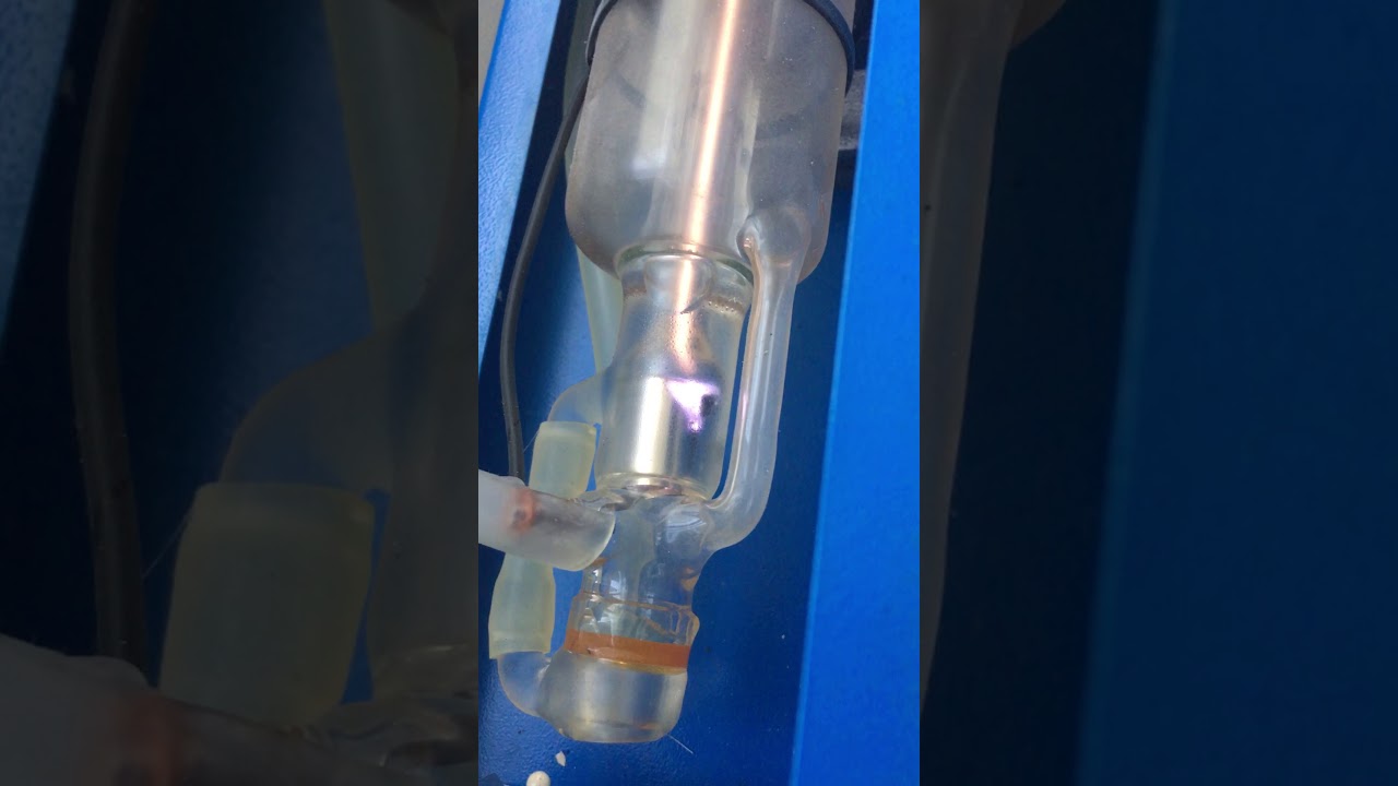

cutting at 40 / 50 / 60 / 70
Oops I’m sorry I meant to ask you to video the tube during those power levels.
I am wanting to see what the plasma looks like when it fires.
40%
50%
60%
70%
should it be doing this , the silver part inside the tube looks burnt in one edge
The plasma looks strange at the cathode end.
I am betting that it’s a bad tube but cannot be positive …
