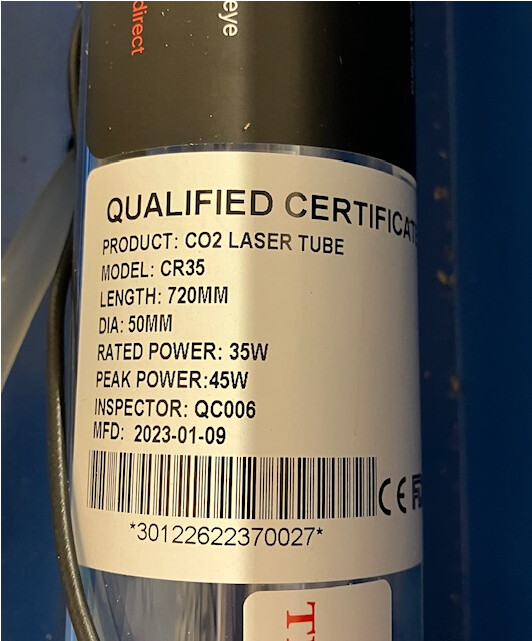

  2. The new tube is Cloudray – 35-45w, diameter: 50mm, Length:720mm.

you should have a label on your new tube which states what the max current is and you should know that these new tubes are way better than the stock tubes shipped in K40 machines which were basically closer to 30-35W tubes which was why we’d run them no harder than 18mA.
You should get much better output and life from the new tube as they usually test a 40W tube at 50W and sell them as 40W expecting you’d want to run them at 100%.
