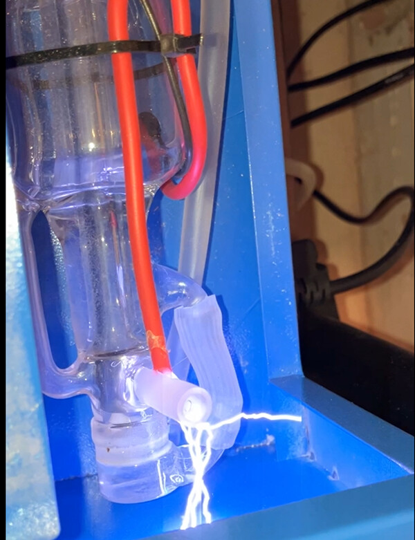

I have had my K40 fully working around a month and apart from initial setup problems, it has been fully working for a few weeks. Right up to last night, it has been working well but this morning, I went to do some ply cutting and I believe I am hearing arcing which I have never heard before which is coming from the back end of the tube. Before sending this post, I looked at the “Broke my K40” post to see if there is anything I should check after noting Don’s point when I was setting it up about the LPS which at that time was shown to be fine. In this regard my situation is:
  1. Circulation is working and within the temperature 15C and 20C
  2. I can detect no air bubbles in the tube circulation.
  3. I am using distilled water with algaecide and it sits in a closed system (no ice being added), DIY chiller used.
  4. I checked the LPS again as advised by Don last time. As soon as I raise the voltage above about 0.5v the arcing begins and the milliammeter does not move. Does this mean the LPS is at fault? Are there any other tests I should do? If so, this is the only K40 LPS I can see on Amazon UK that seems to be equivalent to the one I have. If you confirm this is the probable problem, is this the LPS I should buy? I have only pulsed the laser half a dozen times to check the LPS so I do hope the tube has not been damaged.
Whilst I am waiting for my new LPS to arrive which should be tomorrow, I captured a screenshot of the arcing and a couple of photos of the tube. As the arcing is coming from the tube itself and not within the LPS, does that suggest that it is the tube that has failed rather than the LPS? The photos suggest there is some pitting within the tube and that the insulation has been compromised.
Ummmm…hmmm…that’s…not …good. :open_mouth: My guess it’s because of that nick in the high voltage wire insulation. Soldering iron damage from when the wire was initially soldered on the tube maybe? I’ll let @donkjr comment on the best way to fix that.

No its not. I’ve had it fully working for a couple of weeks so it seems like an act of God for this to happen. I have a new LPS arriving today so I completely disconnected the machine last night so that the LPS would discharge but I suspect it is not the problem. I expect my next question is going to be when I find the same problem happens (and why would it not!!) then do I keep this new and better LPS or send it back? I have looked into new tubes and have come up with a possibility which gets a lot of good reviews on Amazon but I’ll cross that bridge when I get to it as the hope you seem to be suggesting is that it may be just a case of re-attaching the high voltage wire and I have reviewed @donkjr post about changing the tube.
Actually, if memory serves me right, the arcing could be caused by a bad LPS.
You definitely want working insulation, but also check all the wiring from the other end of the laser tube to the ground.
Ah, yes that’s what I was thinking about.

Also, others have pointed out many times your wiring is damaged and until and unless you fix that you will not have a successful arc-less laser system.
Your points are fully taken onboard and I will check all connections in the circuit. So once I have checked them all should I then try to refit the connection from the current LPS to the tube or the new LPS to the tube as this is clearly the weakest point. Once I disconnect the high tension wire it may be clear what the problem and I have to do this anyway if I am going to fit the new LPS.
I would check and validate the connections to the laser tube coming from the LPS( red?) all the way back from the tube to the LPS(black). If a bad or poor connection is found and fixed, I would then repair the insulation on the red wire at the tube and try the existing LPS again.
BUT THAT INSULATION REPAIR MUST BE DONE AS A HIGH VOLTAGE INSULATION REPAIR. Not just wrapping some duct tape or electrical tape around it.
Ok will do. I have noted @donkjr blog on how to re-connect the laser connections and understand the requirement is that it is a high voltage repair. Once I disconnect I may be able to see if it is bad connection or a bad tube and I will post some pictures. Although I think the consensus of opinion is that my current LPS is probably unloaded, it is worth trying it first once I have re-fitted the connection. If that does not work I will know and I can then try the new LPS unless it is obvious the tube is bad. Many thanks to all for your assistance so far.

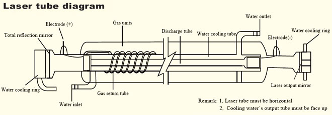

Just curious, is there water flow ONLY in the middle section of the tube? See diagram below:
lasertubediagram
Yes I believe so. Its hard to tell with it being clear but it looks no different to when it was working. I did do some changes to my water cooling and so had to re-bleed the system. Bubbles always form in the neck of the tube and are easily moved into my flow indicator which sits at the highest point in the circuit and by inverting this they then flow into the return bucket. I will be carrying out the test with the new LPS later this afternoon.

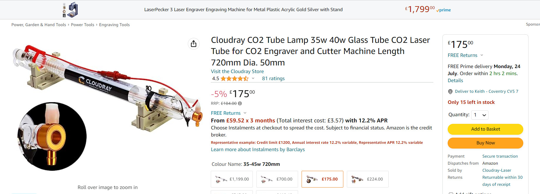

I am disappointed to confirm that I still have arcing from the anode with the new LPS. As I confirmed yesterday, I believe all other connections are good. If there is nothing more I can check should I presume that the tube is bad? If so, I have highlighted two from Amazon UK: The Cloudray is rated at 35-40W and the MCWlaser is rated 40-45W and both have good Amazon reviews. If the tube is considered bad, could it be the current LPS is actually ok or is it likely that if the tube failed first it would take out the LPS? Is there any other way of testing whether or not the LPS is bad or would you simply suggest changing both the LPS and tube together?
