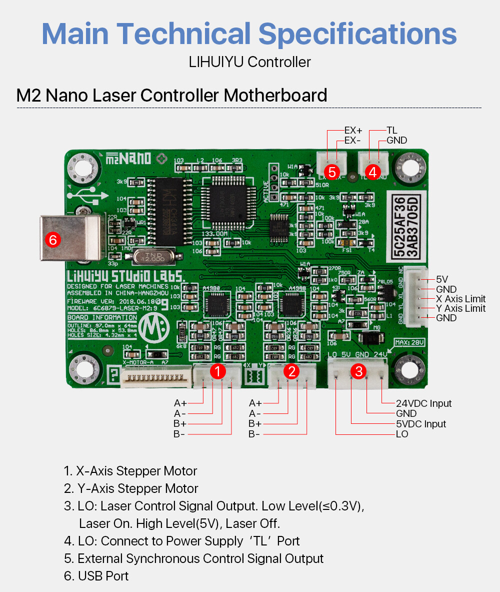

Hi All,
I’m building a rotary bed using a NEMA17 motor that came with a different color scheme for the leads than the stock Y motor’s red/blue/white/yellow. In this case the motor has black/green/red/blue and the specs do define them as A+/A-/B+/B-.
Where can I find information on mapping the new motor to the right pins on the controller?

perfect! I swear I went looking for a diagram like that and came up blank!
