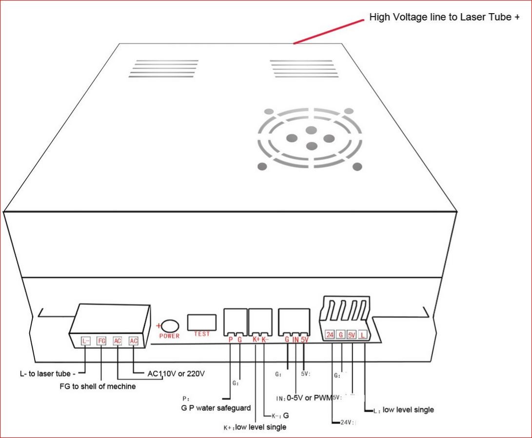

Here’s the pinout of each. Notice that the White Supply typically uses 3 ground pins where the Green model shares 2.
You can interconnect them or daisy chain them in any order and it will all work fine. Under the board, they are all tied to the same ground point.
While on the Ground subject, there’s another odd thing done in the K40’s power supply connection arrangement. You’ll notice the AC Mains connection (the far left connector, ALWAYS Green (so far)) has 4 connections. The right 2 are AC power (220 or 120v), and pin 2 is earth ground, all as expected. It’s pin 1 you have to watch out for. It’s the DC return for 15000v tube power. It MUST be connected (properly!) or you will expose anything near the wire to 15kv at lethal current levels. The K40s tube power + goes straight to the tube, but the ground is connected from the tube to the Ma meter, then the Ma meter runs to Pin 1 of the mains connectior. It is indeed tied to earth (and system) ground. ALWAYS make sure it’s connected to the correct pin, and tight.
Here’s a “cheat sheet” on the connections for each PSU.
Green Supply
Leftmost
Connector #1
Pin #1 HIGH VOLTAGE Return (from ma meter)
Pin #2 AC Ground – goes to Chassis Ground and Mains Ground
Pin #3 AC IN #1
Pin #4 AC IN #2 (In US, either can be Neutral)
Middle
Connector #2
Pin #1 (G) “Laser Switch”, “Test Switch”
Pin #2 (P) “Laser Switch”
Pin #3 (L) “Test Switch”
Pin #4 (G) – Pot CCW Pin (turning knob ccw contacts this)
Pin #5 (IN) – Pot Center Pin (0-5V DC output level control)
Pin #6 (5V) – Pot CW Pin (turning knob cw contacts this)
Rightmost
Connector #3
Pin #1 24Vdc out – runs to motor controllers
Pin #2 Ground
Pin #3 5Vdc – Control power
Pin #4 “L” or “LO” Laser control. This turns ON the 15KV power when pulled to ZERO volts (Negative logic)
White Supply
Leftmost
Connector #1
Pin #3 AC IN #1
Small 2 pin ‘XH’
Connector #2
Pin #1 (P+) – “Laser Switch”
Pin #2 (G) – “Laser Switch”
Small 2 pin ‘XH’
Connector #3
Pin #1 (K-){really Gnd} – “Test Switch”
Pin #2 (K+) – “Test Switch”
Small 3 pin ‘XH’
Connector #4
Pin #1 (G) – Pot CCW Pin (turning knob ccw contacts this)
Pin #2 (IN) – 0-5V level control to High Voltage Power Supply
Pin #3 (5V) – Pot CW Pin (turning knob cw contacts this)

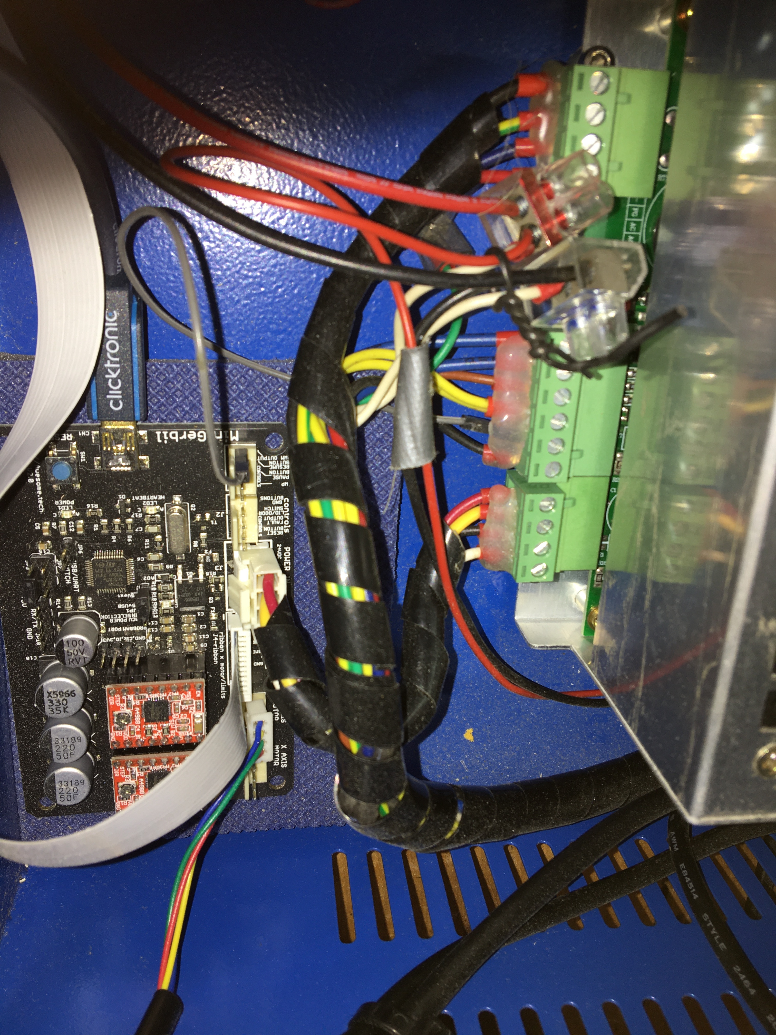

Looks like you have a grbl controller but I cannot tell how it is connected to the LPS.
If you need more details/help let me know
Many thanks Don, mainly I asked because I am a little jealous of the power supplies with the small hole in the side (and a pot on the inside), which can be used very easily to adjust the output power.
Hi Bernd,
I am setting up my laser with a Grbl board and was wondering if you are using PWM for raster engraving or are you just using “on/off”. Would you be able to detail how you have connected you board to the LSP?
Thanks in advanced,
Ed
Hi Ed, I use the “default settings” from Awesome Tech and have never touched it because it works fine as it is. On the AwesomeTech page there is some nice information which also deals with the PWM settings.
The pure physical connection is plug and play, Nano out Mini-Gerbil in.
The original potentiometer from K40 is “disconnected” when you change the board, i.e. you can only adjust your powersettings via LightBurn. Be aware that your max. power does not exceed the approx. 60% in LightBurn, unless you have the option to throttle your power supply. (it was not possible with mine)
