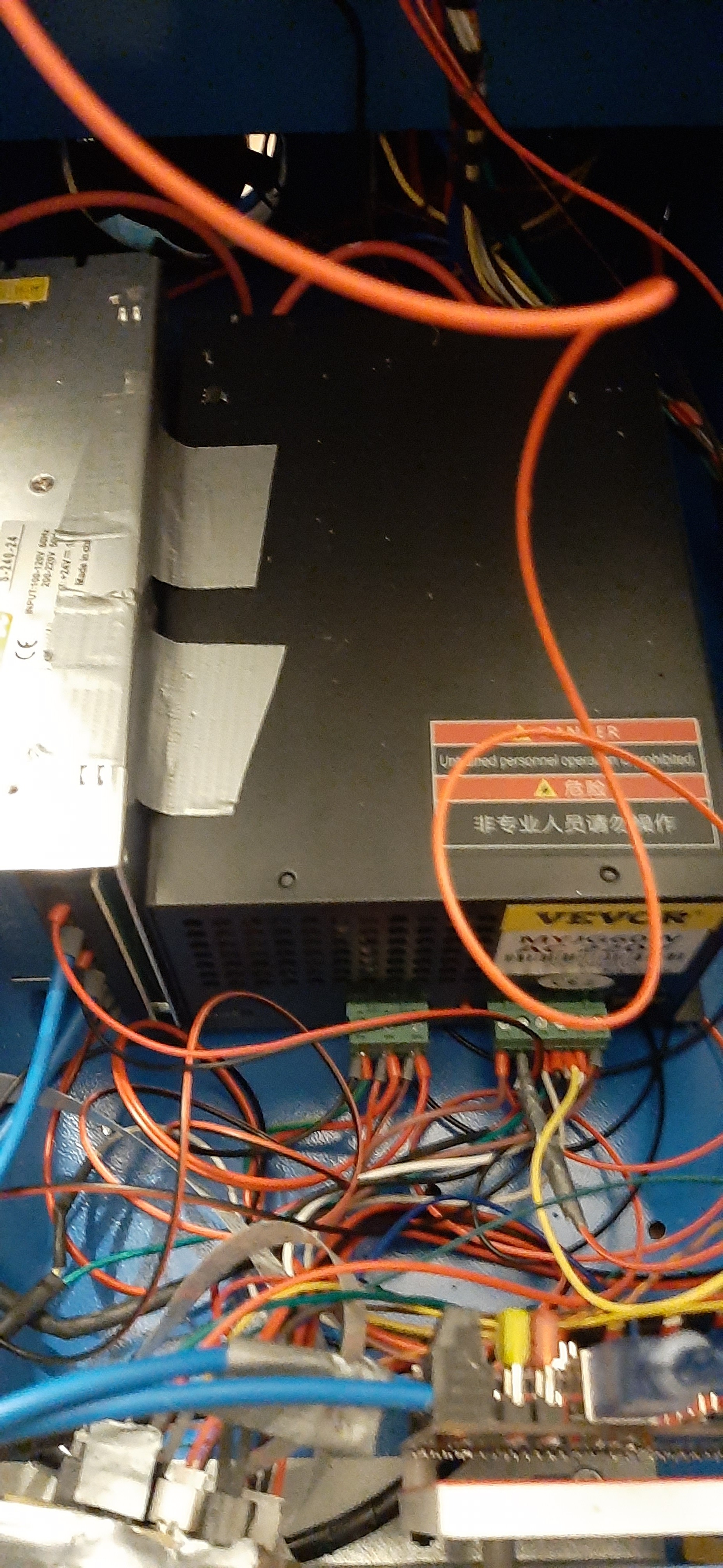

Setup is as above, 50W laser 60w vevor MYJG60 power supply, SKR 1.4.
It seems that no matter what I try I cannot get a reliable PWM signal to activate the laser properly so I end up with intermittent images as it seems the laser is not activating, deactivating accordingly.

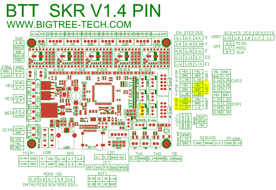

I connected the Servo output 2.0 to the pot in series then to the IN pin of the laser supply. The probe pin 0.10 is currently connected to the power supply pin for turning the laser on on 0V input.
The ground from the LPS is connected to the ground from the SKR 1.4 which is connected to the ground for the 24V power supply which powers the SKR1.4.
