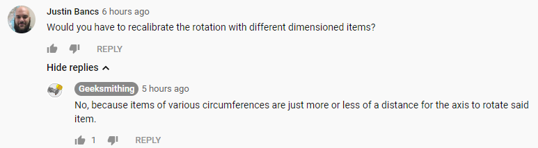

Does the rotary scale factor need to be calculated/changed for every different diameter of objects you are engraving?
