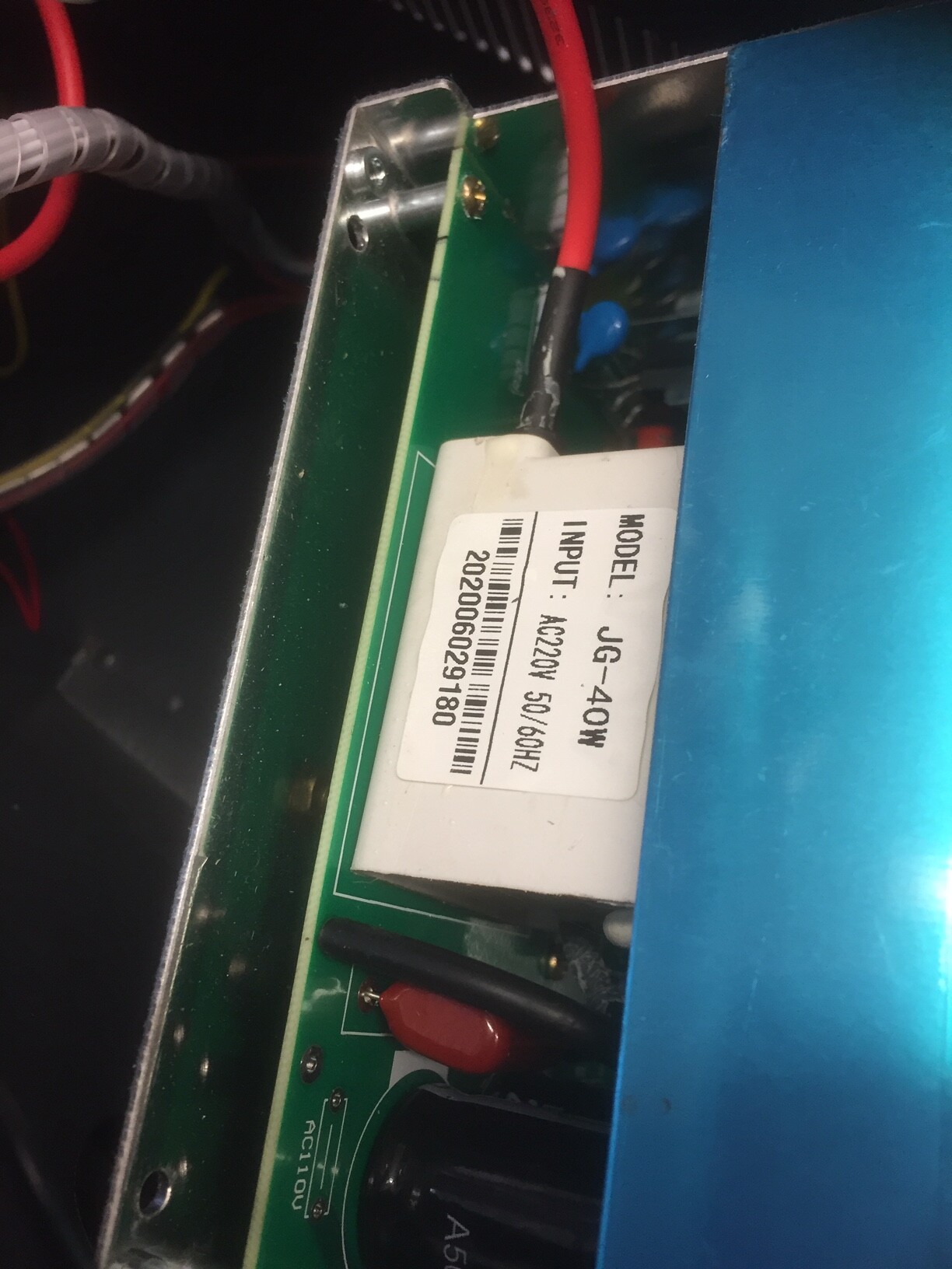

Attached I hope are some photos. As I say I think the tube has had it. Look forward to your comments. Thanks
Rog
It may very well be that your tube is bad but I am wondering why you are not getting some kind of output from the LPS. Even with a bad tube you should see arching, hear buzzing when you push the test …

Picture 3:
Is that picture with the machine turned on?
When the machine is turned on what lights are lit down on the LPS
Picture 4:
- Not related to this problem but I would reroute the blue wire (sensor?) away from the red high voltage.
- There are two red wires coming from the right of the picture one goes to the tube one goes down into the cabinet. Is that a splice or what?
