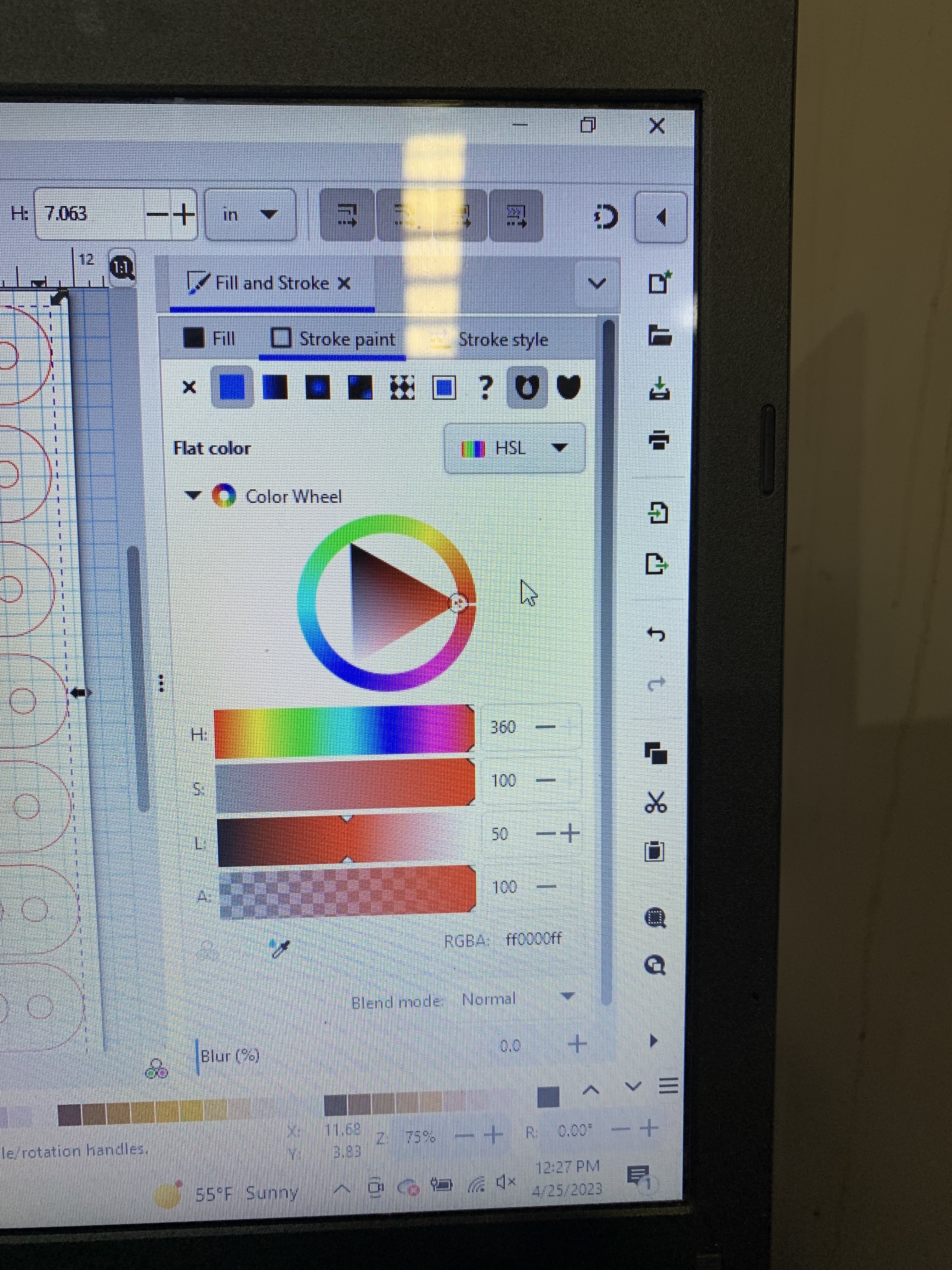

That didn’t work. finally I was messing with the color wheel in Inkscape and though it doesn’t say 255 for color it works. I moved the color wheel to the reddest portion and set the others as shown see jpeg below. Really, I think we are just jiggling the handle here.
any graphics program I’ve used doesn’t use a “spray can” to copy anything, it’s a painting tool and in any drawing it does not produce vectors but instead lays down image pixels of color.
if you want lines then you need to create vectors in your drawing. You can have both vectors and images, or just vectors or just an image. SVG files store both types of drawings.
Change the HSL dropdown to RGB.
You can then enter the values, so change red to 255 and green and blue to zero
