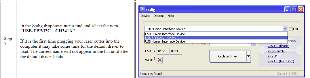

I’ve been trying to connect the laser to the K40 whisperer but it doesn’t recognize it. I followed the instructions from [K40 Whisperer USB Driver Setup] to install the libUSB driver from Zidag. But in step 5, it says select the item “USB-EPP\I2C… CH341A”

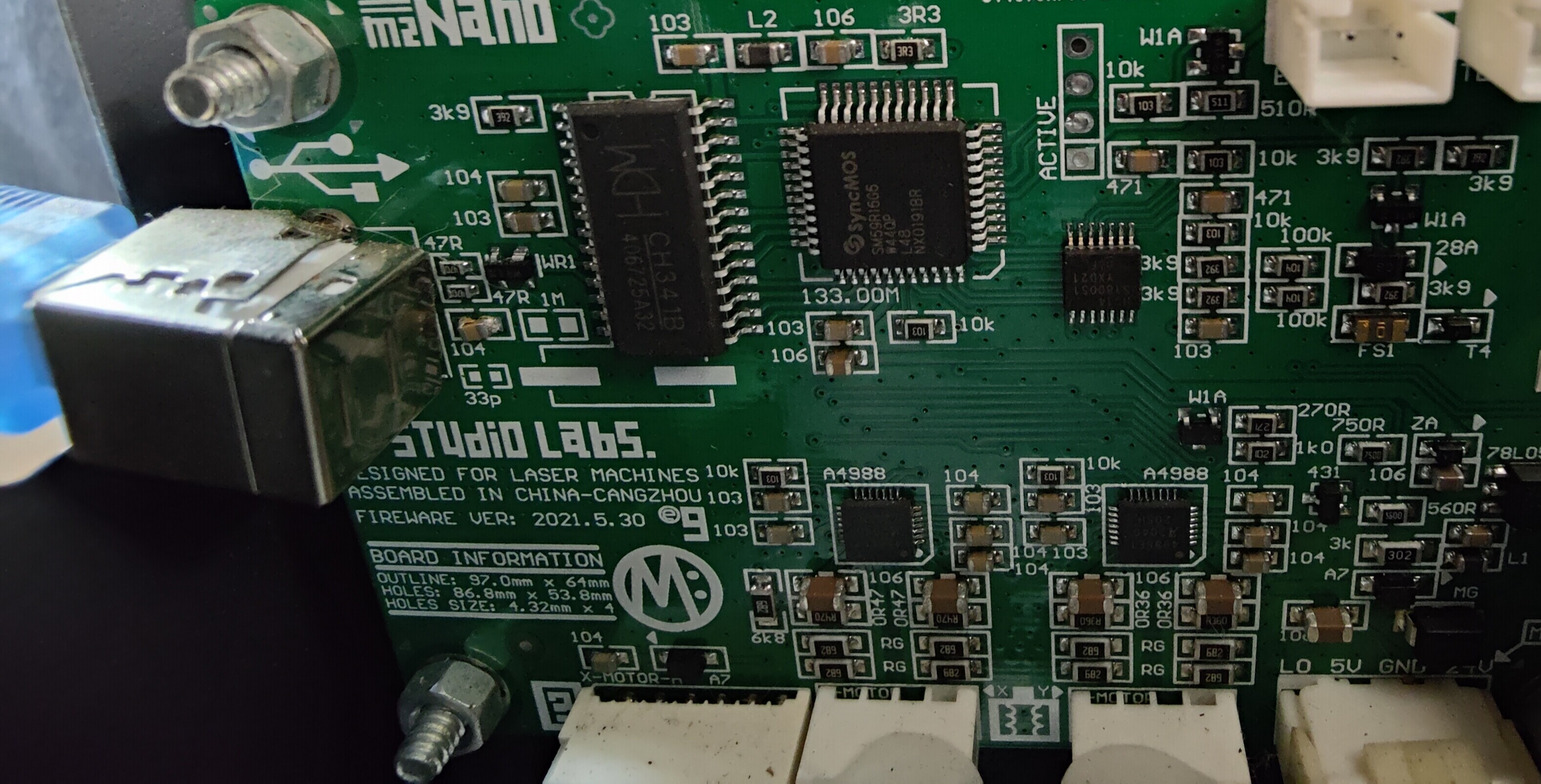

What controller is in your K40 laser cutter? maybe add a photo of it and the machine too.
Is this what you are asking?
K40 Whisperer and MeerK4t should work with that controller but #1 you should read the K40 Intro linked at the top of this page. Yes it is alot to read and yes you might find there are things there you don’t need or care about. But, it will also tell you about coolant flow and temps, about installing a mA meter and probably about how that digital meter is NOT a 0-100% type of control and that anything over 45% is likely to be overpowering your laser and prematurely wearing it out. And lots more.
The other thing is that your USB connector on that board is damaged.
