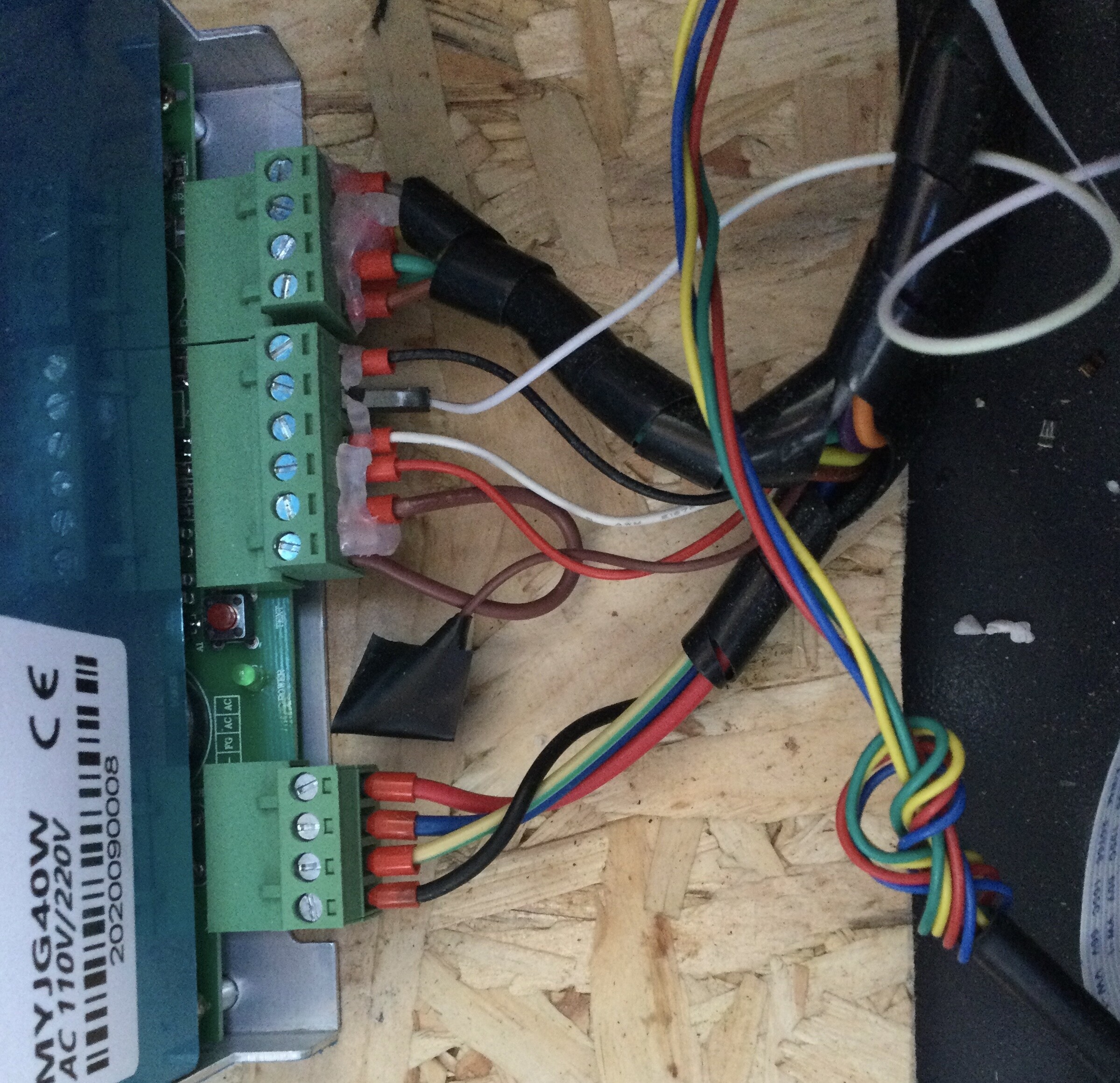

your question 4: connected with pwm lead from mini gerbel controller as photo.![IMG_0060|375x500]
(upload://bGYHVbHNN8LzAV7IWSKGH34QayE.jpeg)

Let’s use this drawing to identify connections on the LPS:
Ignore everything but the pin numbers for now.
Where do the other ends of these wires go:
1a. P2-1(black): ?
1b. P2-2 (white with black housing):?
1c. P2-3(white):?
1d. P2-4 (red):?
  1. Where does the brown wire that it disconnected and taped go to?
