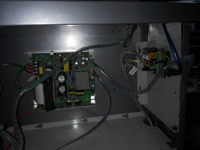

Regarding the cover of the LPS, I got mine without the cover:( So, as on picture in my previous post…
First be warned that the LPS is LETHAL getting anywhere near it while it is on can KILL you!
You need a cover for noise and safety reasons.

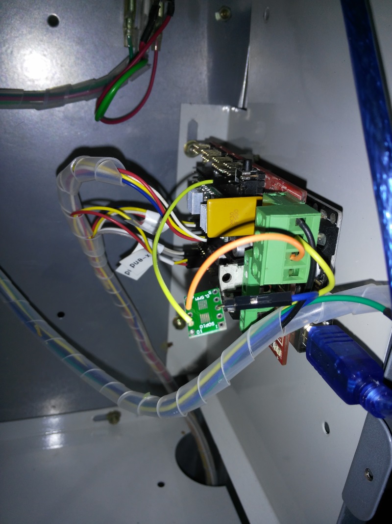

@morfeus Also would be useful to post picture of the physical 2n7002 wiring and location?

Hi,

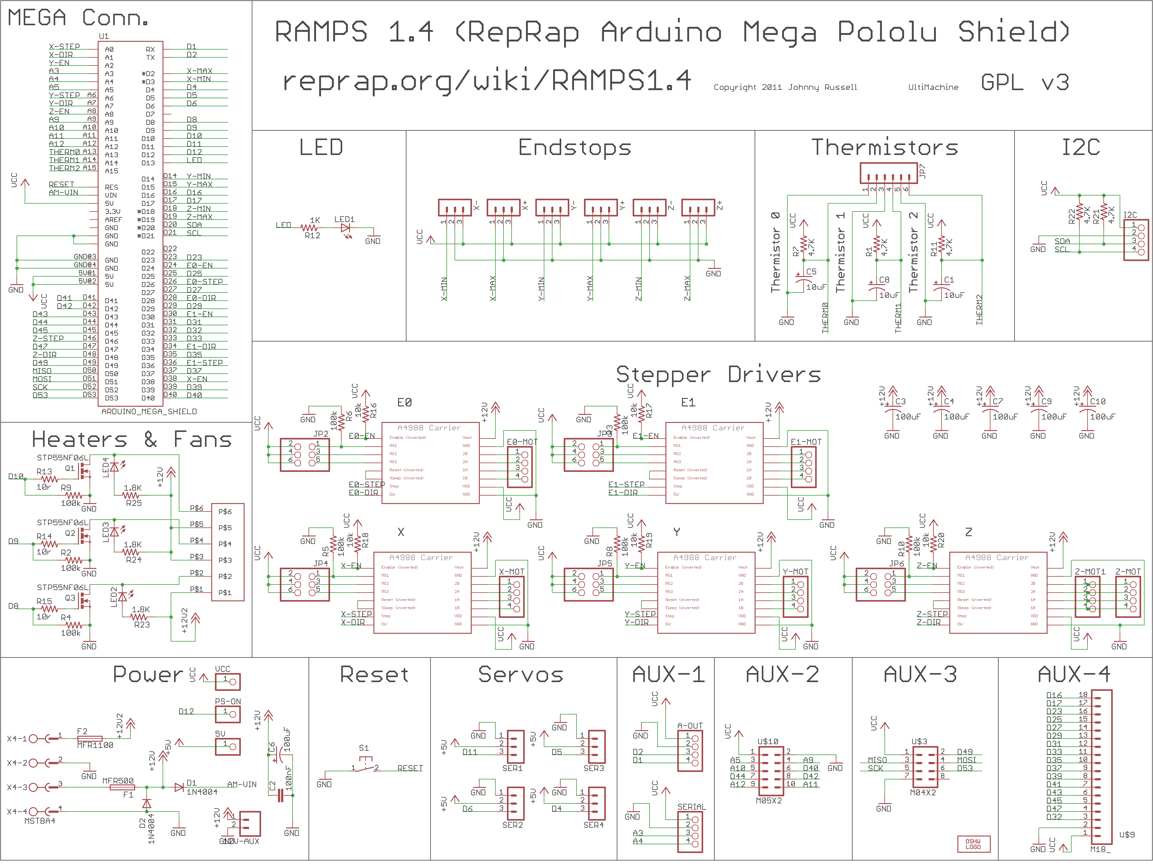

The mosfet is on a small PCB together with an 100kOhm resistor. All together is connected to D6 on RAMPS. The schematic is:
  1. Gate to D6 and one lead of 100kOhm resistor
  2. Source to GND and second lead of resistor
  3. Drain to “L” on LPS
    Place inside the laser and the actual board can be seen here (small PCB near RAMPS power connector with yellow, orange and blue wire):
    So I think that should be OK?
The fact that arduino stops to communicate when laser fired only with “Test” button is what concerns me the most because in that case Arduino is not communicating to LPS at all. However, I didn’t try to unplug the “L” pin from arduino and then fire with “Test” button and check what happens…

  • Why are you not driving the L pin directly from an open drain on the ramps?
  • I don’t know what D6’s output circuit’s looks like
  • Your gate pull-down of 100K seems high, try 10K
