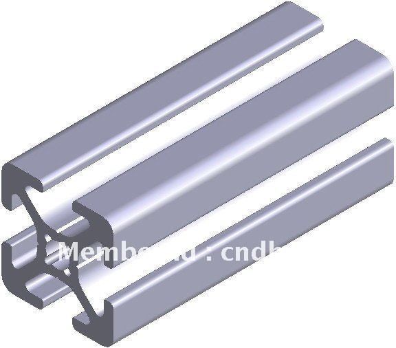

@Tim_Rastall Nope I haven’t printed anything yet. I was planning to start tomorrow. I’ve already downloaded the files so I’ll just delete those that I have and re-download after you update them. Thanks for the heads up. Let me know when they are updated…Thanks. Also @ThantiK had mentioned to me that you have a lead on where to order the T-Slot from, any help there would be appreciated.
@Mike_Smith P5 20X20 6pcs L1000mm aluminium profile
