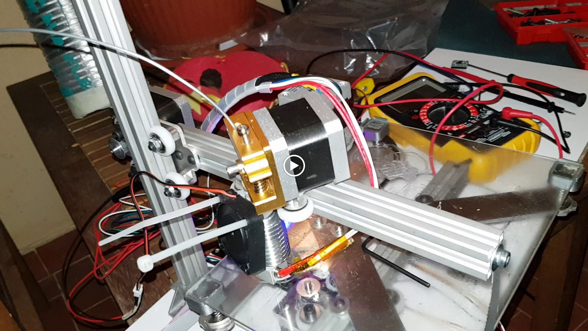

Larger crane-style printer I found a friend working on this morning,
Larger crane-style printer I found a friend working on this morning, I recognize the cheap chinese filament drive (it is REALLY bad; their tension adjustment mechanism is done super wrong) – Running the motor on top of the axis instead of bowden-ing it is a little odd.

exxential in cetus/printerbot version (no endstop for that flat start) , too much ghosting causing from glass not attached on magnets and acceleration too hight for X stepper. this afternoon clean nozzle no close fine and re-try (franky are 0.1 layer resolution)
HAHAHAH you don’t notice how i fix fan for clone v5 :smiley: , for story that printer born/design/make in 3 day. Today hope have time to fix ghosting too . anyway really low budget and around 1mt of profile.
Anyway xyz use same system for moving nema 14 0.8a or 17 0.7A for XY and 1.7A for z and filament feeder (sorry no remeber fast torque value), surely not study for high acceleration but only for build it fast. for that use direct on carriage that strange/absurde but work…that what i need if sell printer surely no use that cheap items but surely i don’t denigrate that, not efficent at 100% but works for my study.

Wow that’s… different. I am interested in seeing print quality lol
aria as original size in printing
I love that fan attachment. It’s exactly the kind of last minute “eh, it works for now” fix I’ve done before.
fan not a must but that are a top… no remeber to close fine nozzle. :smiley: now printing in that situation… short time for my hobby :smiley: , hope tomorrow have little more time where print stabilizer of Z and other part… some minute more and finish aria…for now secret.
:frowning: ok write gcode for homing hot extruder on one wings, anyway that print permit to see more difective are on x where create more vibration and that create a micro wobbles and ghosting Z need add a piece for remove another piece of vibration need print endstop holder and upgrate
The gray head print photo looks like it has really, really bad stepper ripple. Like an 8825 running at low speed in mixed decay mode.
ryan bad ripple are caused from that , vibration push all on profile and after on glass… and too much creative attach of bed :slight_smile: tomorrow see to resolve that i have 2 solution need try. addded image of issue on last album
