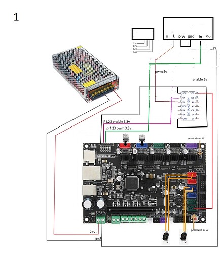

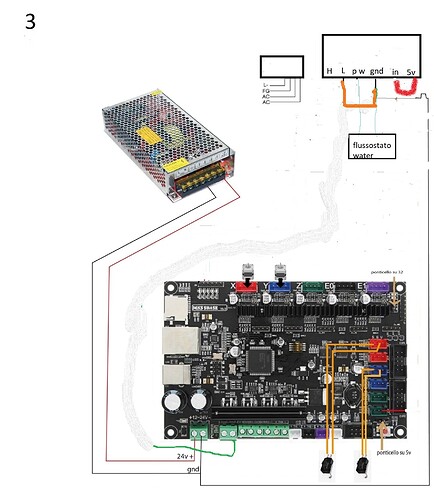

scheme n1 maximum power 8 ma
scheme n2 maximum power 20 ma, when the laser moves it stays on 3 but ruining the job

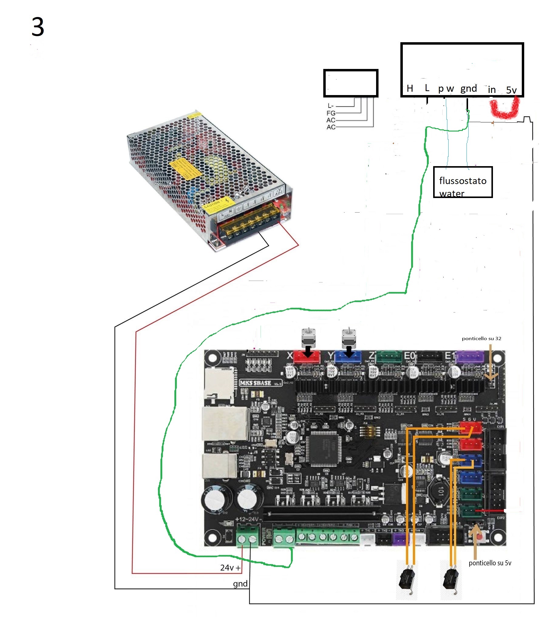

scheme n3 maximum power 15 ma
We need to stay with configuration 3.
Can you measure and tell me what the voltage on IN is in configuration 3
i measured between IN and GND, it comes out at 03.4 on the tester
It should be 5V isn’t it connected directly to the 5V pin?
Measure the 5V to ground.
if I measure between 5v and gnd it is zero, because I discovered that this psu does not have 24v, and it does not even have 5v
