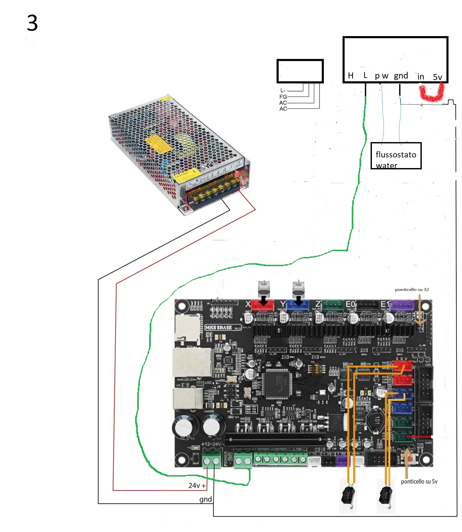

hi forum, I built a laser with psu 50w + tube 50w, I loaded grbl-lpc (c.prezzi
) on mks sbase, I connected L hotbed less, it does not work well, I have at maximum power 9 ma, the tube and psu they work well, I attach my psu connector and schematic

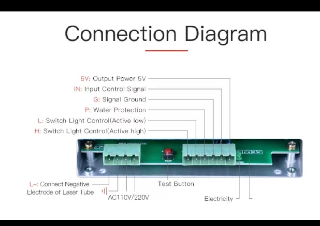

Do you have a potentiometer connected to G/IN/5V?
no without potentiometer
Do you have a jumper wire installed which connects IN to 5V?
With these odd controllers which only use L for on/off and power, you either need a jumper wire to set the max to 100% of what the PSU can deliver or a potentiometer which acts as a limiter.
The max current of the PSU is usually higher than what the tube was rated for. Limiting the current in software or with a trimpot is definitely a good idea.

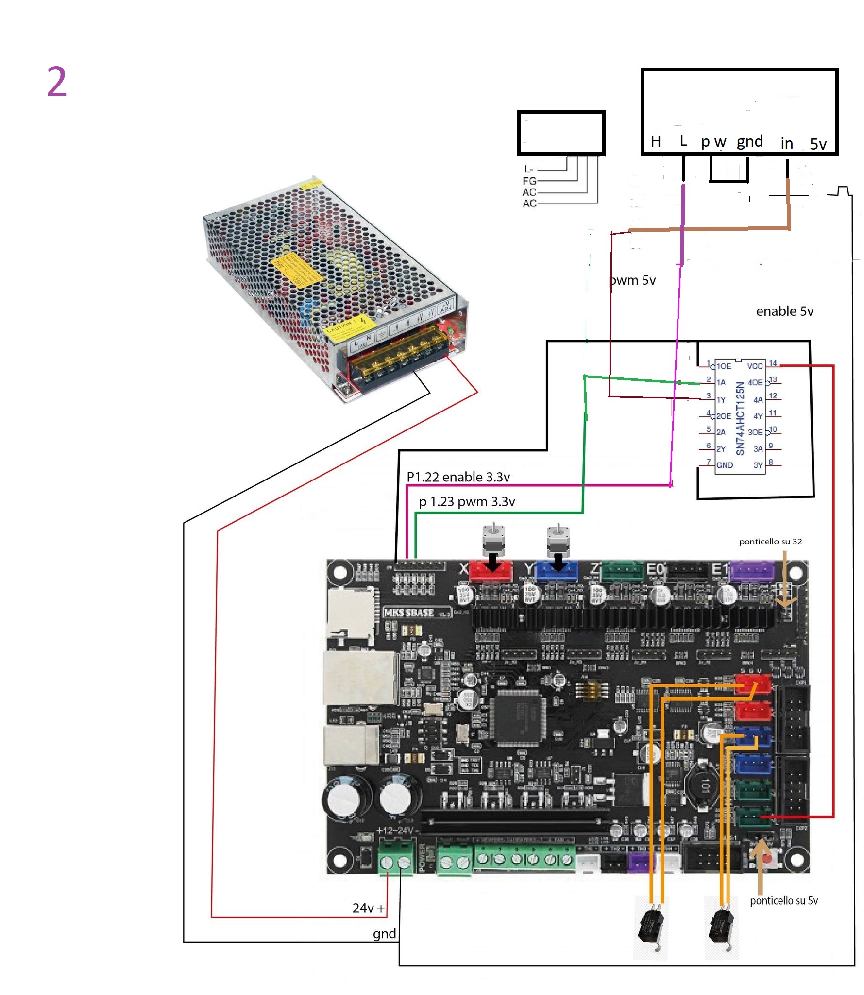

I tried 2 different schemes with logic converter, scheme n 1 max 8 but, scheme n 2 max 20 but but when you move the laser in the passages it stays on 2/3% and it ruins the cut pieces

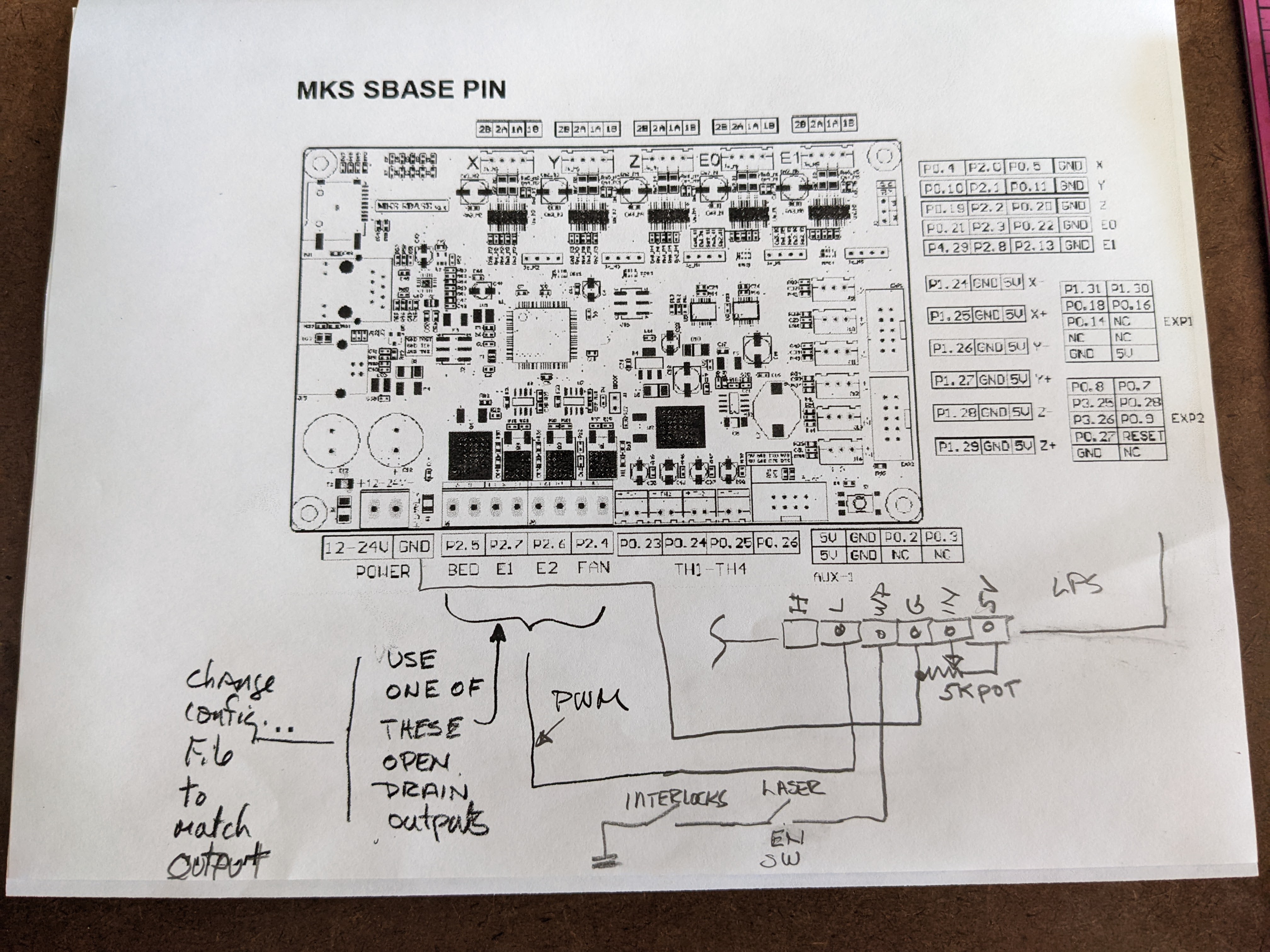

I would recommend this configuration:

Then the configuration I gave you should work.
I use this configuration with smoothieware + Lightburn in my K40.

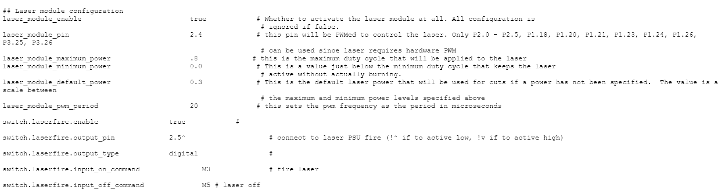

Laser module configuration
laser_module_enable true # Whether to activate the laser module at all. All configuration is
# ignored if false.
laser_module_pin 2.5 # this pin will be PWMed to control the laser. Only P2.0 - P2.5, P1.18, P1.20, P1.21, P1.23, P1.24, P1.26, P3.25, P3.26
# can be used since laser requires hardware PWM
laser_module_maximum_power 1.0 # this is the maximum duty cycle that will be applied to the laser
laser_module_minimum_power 0.0 # This is a value just below the minimum duty cycle that keeps the laser
# active without actually burning.
laser_module_default_power 0.3 # This is the default laser power that will be used for cuts if a power has not been specified. The value is a scale between
# the maximum and minimum power levels specified above
laser_module_pwm_period 150 # this sets the pwm frequency as the period in microseconds
switch.laserfire.enable true #
switch.laserfire.output_pin 1.22!^ # connect to laser PSU fire (!^ if to active low, !v if to active high)
switch.laserfire.output_type digital #
switch.laserfire.input_on_command M3 # fire laser
switch.laserfire.input_off_command M5 # laser off

In the meantime here is my config file for the laser. Ignore the switch commands
donkjr pin 2.4 is not pwm, why did you put switch.laserfire.output_pin 2.5 ^? this pin is hot bed less
send me your configuration to try it out
I just wanted to show you inversion/not inversion on a PWM pin.
You will need to configure for whatever pin you are using for PWM [2.5?] for whatever direction you want the PWM Signal? The LPS-L pin wants a ground true (turns on) signal
laser_module_pin 2.5 in your case looks like it should work.

with the n2 + smoothiware scheme I do not lose steps and arrive at maximum power 20 ma, but when you move the laser does not turn off it remains lit 2/3 but, the n3 scheme with jumper 5v + in, I arrive at maximum power 15 ma and the laser turns off when you move
I believe N3 is the correct configuration.
